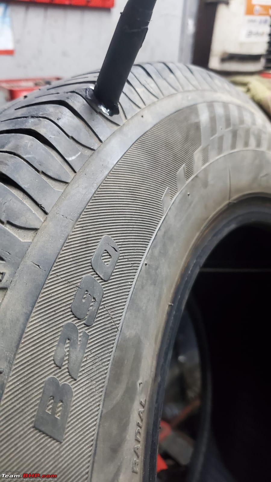

Hello, Newbie here! It's weird that I've been a passive follower of team-bhp since 2012, and make my first post only now. T-BHP has been an excellent source of information for all my auto-related queries. Kudos!
Coming to the episode, this happened last weekend on NH48 between Krishnagiri & Hosur. I was cruising at a comfortable 120kmph, and all of a sudden hear a very brisk hizz sound from outside the car. Hoping all is well, I slowly moved to the side of the road and noticed that the sidewall of my right-side rear tyre had a blowout. For then, had replaced the spare and drove home.
I had replaced my tyres (Bridgestone B250) few years back and it had run only around 9-10k kms since. As I did not hear any distinct thud or sound from outside, I wondered what could have caused this blowout, especially the size of the hole. The hole seem to be sizeable and completely through.
Checked with the Honda Dealer (who had supplied the new tyres) as well as few other tyre dealers and their response was same - cannot claim warranty as it seems to have hit something (the mark on the alloy served as evidence), and the tyre is beyond salvage.
Considering safety, I had replaced the tyre but still can't get it over my head. I was travelling with my wife and my 10 month old kid. Could it have been worse? What could have caused it especially on the highway? How can I prevent this from happening again?
Apologies for the photo, shot it in dark using mobile flash.

Old 14th June 2019, 10:45   #125
Santoshbhat's Avatar
Join Date: May 2011
Posts: 2,362
Thanked: 7,209 Times
Re: Sidewall puncture in tubeless tyre
There seems to be considerable amount of rubbing/ friction marks on the sidewall. The Bridgestone lettering is almost half worn! This has led to weakening of the sidewalls which eventually gave way.
This kind of rubbing happens due to kerbing while parking. Do you park in a tight place which requires you to get very close to a footpath or kerb? Always ensure that the tyres don't make contact with the kerb while parking.
Edit : The rubbing marks are most likely caused by the tyre running flat after blow out. But kerbing is one of the most likely causes for sidewall damage.

Old 15th June 2019, 16:50   #126
allwynkingsley's Avatar
Join Date: May 2014
Location: KA51
Posts: 8
Thanked: 6 Times
Actually, yes my parking is in a tight space in the basement, but I haven't noticed the marks before this incident. As you said, it should have been as a result of the tyre running flat.
