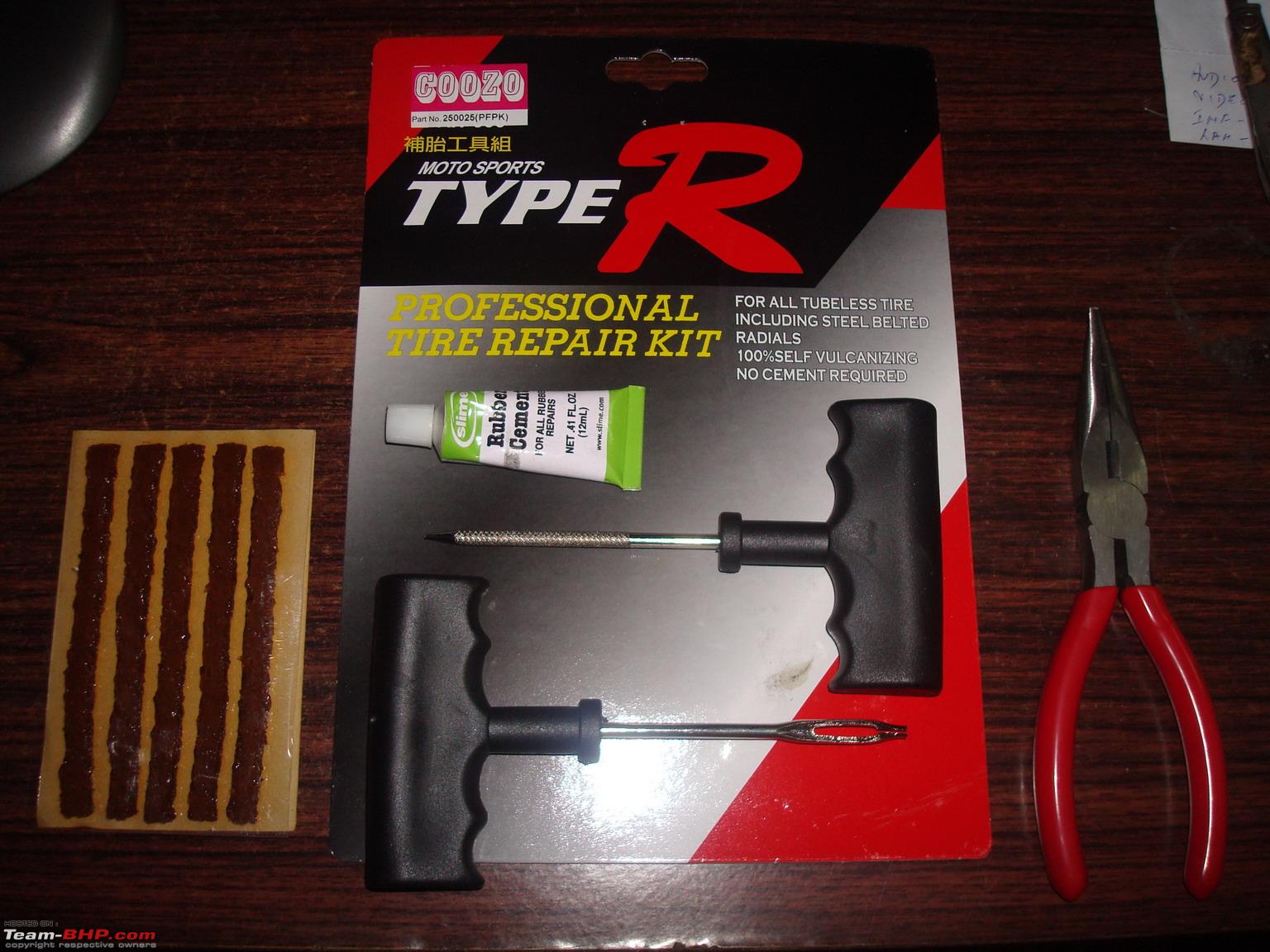

Tubeless Tire Puncture Kit
I just purchased this Tire Repair Kit from Metro (Cash & Carry). Kanakapura, Bangalore priced at 225/-, here are its pictures.
