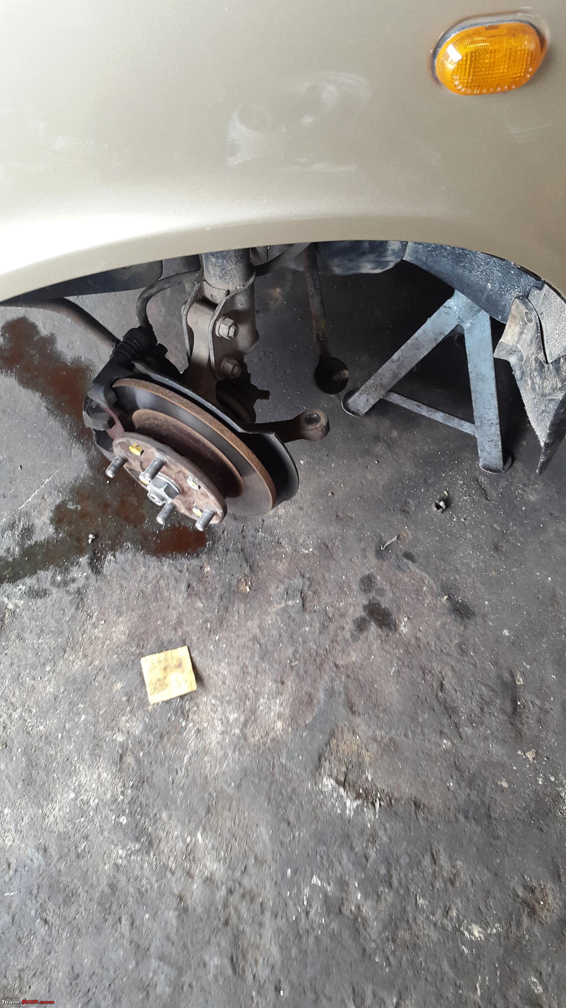

Thanks for pointing that out, but I forgot to mention, my 800's 5th tyre, which is a tubed radial, took weights on both the outer and the inner lips during the same balancing. And mechanic didn't change any setting, so I doubt that is a case of static balancing.
I also got the balancing checked on machine of local Maruti dealer, and they also confirmed the balancing to be perfect.
However I must mention that the steering used to feel ultra-light after 110kmph, and I guessed that it might be due to the ultra-light weight of the M800. That issue was also recently solved when MASS changed something called tie-rod ends on my car. Improvements noticed after that
1. Better return of steering.
2. Steering no longer feels disconnected.
3. No pulling while hard braking.
4. Steering now points straight while going straight-earlier it was tilted a bit towards left.
Everything about Wheel Alignment: Post your queries here-20151015_100540.jpg
Everything about Wheel Alignment: Post your queries here-20151015_110131.jpg
Everything about Wheel Alignment: Post your queries here-20151015_111539.jpg
I was so delighted after the improvements that I detailed my car for a good 9 hours and fell ill the next day.
Everything about Wheel Alignment: Post your queries here-20151014_170251.jpg
Lastly, special thanks to Parag Sir, SS-Traveller Sir, Saket bhaiya(Saket77), Audioholic and you( Humyum) for answering my every query patiently.
