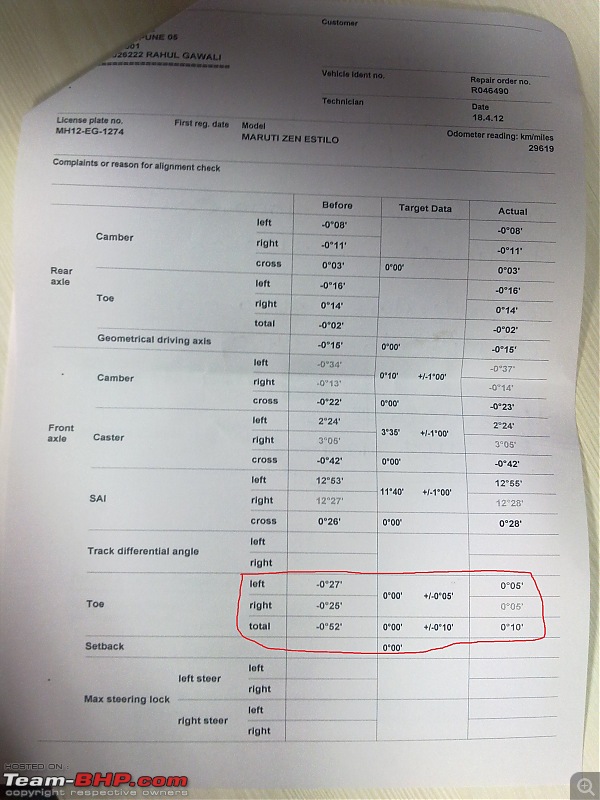

Dear Nikhil,
What a nice thread and information on wheel alignment, wish I could have seen this earlier.
I am doing regular service for my Zen Estilo from MASS and they check if the WA/WB is required or not every time. Lastly I was facing issues like vibration on above 80 Km/hr also it appeared as if left wheel was banging hard when going over speed breakers (speed 20/30 kms/hrs). Recorded this in last servicing but no solution or satisfactory answer so today went to a local WA/WB center and found that there was huge difference in Toe measures and which caused uneven wear out for tyres which are already done 30K kms.
Technician did a tyre rotation and said that 2 tyres have a out and need replacement. I asked him if wheel balancing is required and he said WB is not needed for tyres which are above 30K kms as rubber is hard and which will add no value.
So my questions are:
1. Is this true that WB will not add value?
2. What will be cause for left wheel banging hard, I guess suspension and going to check this with MASS?
3. Changing only 2 tyres is advisable or should I change all 5 after some time (he said 3 tyres can go 10K kms more)?
4. I am thinking on up sizing for better grip on high speed, what size and company is advisable , OE size is 145x75 R13?
I am attaching the latest print of WA.
Everything about Wheel Alignment: Post your queries here-19042012005.jpg
Thanks,
Vishal.

Re: Everything about Wheel Alignment: Post your queries here
Originally Posted by Nikhilb2008 View Post
It's a common misconception. But it doesnt matter. Rotating the wheels will have no effect on the alignment. Neither will a tyre change!
Most of the time, people do balancing/rotation first and then the alignment but there is no technical reason for that.
Are you sure about this? I agree with you on a purely theoretical point of view. But on the floor, I think there will be a considerable variation in the alignment if the balancing/rotation is done after the WA!
WB will definitely add value! Infact, WB has nothing to do with the age of the tyre. You have to balance your wheels everytime you change tyres for best results. The bouncy ride above 80kmh could be due to many reasons but one common reason is improper wheel balance.
ajman28 is offline   (1) Thanks
Thanks,
Vishal.
WB will not make much of a difference with alignment but a badly balanced or unbalanced wheel can aggravate existing alignment problems. It can also cause misalignment faster than normal due to higher wear and tear.
Left wheel banging hard could be a suspension issue.
2 tyres changing is ok. Not a big deal, but ideally, 4 tyres is the best.
From 145/70-13 (not 75), you can upsize but wont find much of a difference. Very few upsize options as well.
Not true. The alignment is done only after loosening the tie rod end. Once the toe is set to the required specification, the tie rod is tightened again and the alignment will not change unless there is a very big hit to the suspension or normal wear and tear. During WB and rotation, no such major change is felt by the aligned suspension.
It does have something to do with the age of the tyres. Not age per se but tyre wear. As the tyre wears, the point of imbalance changes and this is why balancing id required periodically to re-balance the tyre.
