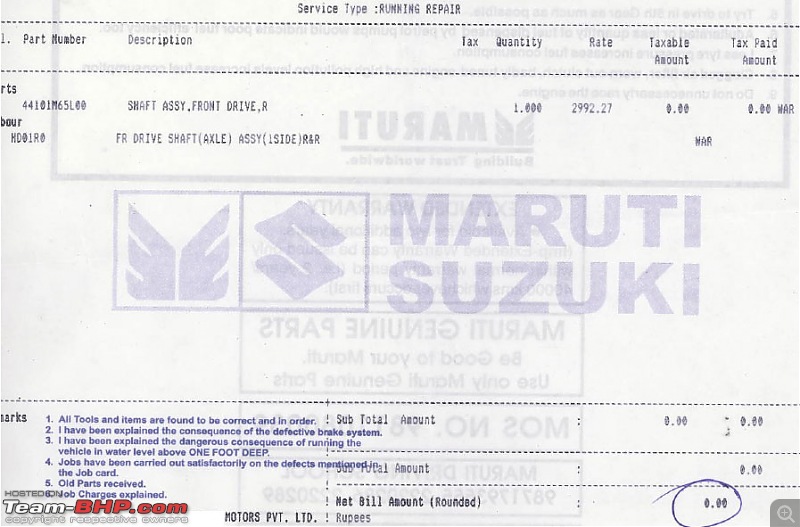

I have a 5 months old Estilo. i am experiencing a wobbling at a speed of 70-80 from last two three months. Last to last week done a alignment and balancing check from the agency and they reffered me to MRF. As per them because of the new car it's a vendor responsbility to take care of this issue.
MRF guys told me that there is some uneven wear at my driver side back tyre so they reffered me to their authroised tyre center to have the balancing and alignment once again. But still my car wobbles at a speed of 70 or 80.
Can anyone please help what to do now?

It has to be a problem with the tyres. Get to the MRF guys and ask them to solve it for you. Take it to another good tyre shop and check out the balance of the wheel assembly again. Usually these guys are either inefficient or too lazy to solve your issue so you end up being bounced between the car dealer and the tyre company, each passing the buck to the other.

See, if what the MRF guys are saying is true (the tyres are unevenly worn), there is not much you can do. However, if the tyre that i unevenly worn is at the back, it shouldnt be a problem. The ride can be a little bumpy but that's it.
I think your agency is trying to act smart. If there is a problem with your spark plugs, will you go to Bosch(who in all likelihood made the spark plugs) or ar you going to escalate the issue with Maruti?
You bought the car from Maruti. Maruti sources it's components from outside. The service centre has no right to ask you to go approach the component (in this case, tyre) manufacturer.
Ask the service centre to solve the problem. Let them contact MRF and figure it out if they have to.

I again went to the agency over the weekend. First without checking anything they told me that a new engineer will come on monday he will check your car . I straight away gone to the works manager and told him then why do you called me today for checking - if you don't do anything today - in that case I have to esclate this matter. Apart from usual alignment and balancing please try something else.
Then he changed the rear tyre with the stepny and assured me if the problem is rectified he'll figure it out how to change the tyre. But the problem still as it was.
Then they told me leave my car for checkup - as it was nothing to do with the tyre, balancing or alignment. At noon i got a call from them - and the problem was due to some manufacturing defect with the front axle and they are changing it. Problem rectified. Here is copy of the bill

I am not that expert of these things but - service centers might try to oversmart by refusing customers and saying words like 'you have to live with this'.
Even in my case, first they totally refused to look into the matter and directed me to the MRF. But after some strict language they resolved the issues. so please go to your sercive center- its their prime responsibilty to sort out any issues customer is facing.
