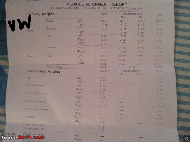

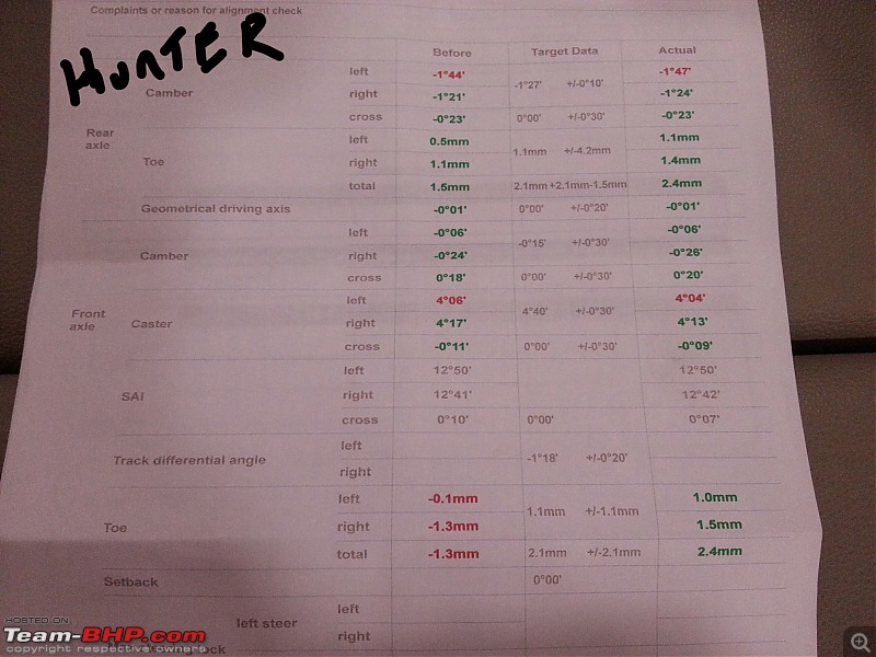

Default Re: Everything about Wheel Alignment: Post your queries here
Hi Nikhil,
Hope all's well.
I'm seeking your expert option and guidance on this left pulling issue which has been bothering me since 4 months. my polo has been pulling left since i got it home. i tried alignment at 2 different alignment shops but it could not be solved. i also got alignment done at vw workshop but it could not be rectified. they have tried rotating tyre left to right, front to back but the issue persists.
I have test driven a couple of my friends polos and they drive relatively straight and also a few demo car polos which all track straight.
yesterday i went to madhus hunter hawkeye alignment workshop here in delhi. they did alignment and my car finally seemed to go straight. i felt the problem solved almost to an extent of 90 %.
however the alignment ustad ji told me to still take the car to vw for alignment as he felt that the RED value of the Left Caster meant some part of the front suspension could be bent like an arm or knuckle. Though he said the value of RED is a very small one and chances of something being bent are small. He told me that if the Caster/Camber values show RED on their alignment machine it means some part is bent/damaged.
I'm attaching report of the Hunter alignment for your reference.
On my way to the vw workshop i felt the car was straight about 90% of the times which was a big relief since i was troubled by this since 4 months....
When at vw workshop i informed them about the above. They told me they will do their own alignment to check this. They did physical inspection of the front suspension on a high lift and then did tyre rotation and alignment on their machine but no values showed in RED. All were in green.
After alignment we went for test drive but the left pulling came back. Then they re did alignment and test drive again the left pulling was still there. VW workshop technicians tried to help a lot and i must say were very dedicated in finding a solution but it could not be solved. It was late in the evening so i came back home.
I am attaching VW alignment report for your reference.
This has left me very confused and i request you to kindly read both reports to help me pinpoint the problem...
Thanks in anticipation,
Rana.

Old 26th October 2014, 00:49   #284
Nikhilb2008's Avatar
Posts: 5,150
Thanked: 8,613 Times
Originally Posted by rana_kirti View Post
Hi Nikhil,
Rana.
That's a long post and I think you realise that the guys at the tyre shop were better than VW fellows :P
The caster being in RED means wear and tear on a suspension component/part. That has to be replaced/repaired. If VW continue their process, they will never solve your problem.
Caster/Camber can get changed due to wear and tear resulting in worn out parts. Normally to bring it back within specification, some components, bushes may need to be changed or some adjustment has to be done by the OEM guys. But in your case clearly they are incompetent.
All I can say is, go back to the tyre shop, solve the problem to 90% and live with it. One of the drawbacks of the OEM guy not giving you proper service I guess.
Nikhilb2008 is offline
