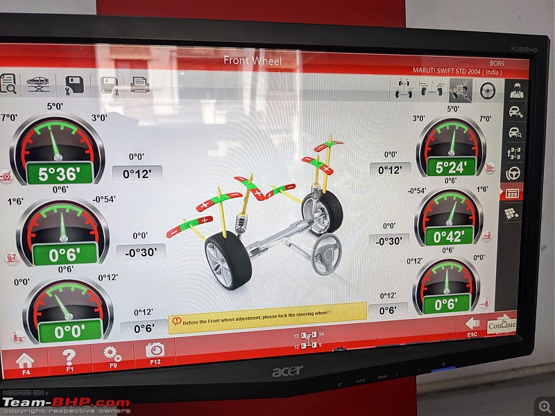

I got wheel alignment and balancing done a few days back as part of regular maintenance. As per the technician, both wheel alignment and balancing were way off although I didn't feel any issues while driving.
Below are the observations after getting the balancing and alignment done:
1. The car is pulling to the left if the steering wheel is untouched.
2. There is a slight tilt in the steering wheel to the left. If the steering wheel is left untouched, it will eventually rotate a little to the left and the car will start going left.
3. The ride is much bouncier than before as if the suspension has gotten softer than before all of a sudden. I have even heard of slight scraping noise over speed bumps which wasn't the case before.
Can all these issues be caused just by faulty alignment done by the technician? Or am I looking at some suspension issues as well?
Please advice.
Please advice.
Care to upload printout of alignment report for better grasp?
Imho, vehicle pulling left whilst hands off (temporarily, with Caution) the steering wheel and its slight tilting is alignment related or caused by alignment.
Hence the request for upload.
No comment on item 3 whilst awaiting comments from the more knowledgeables on this board.

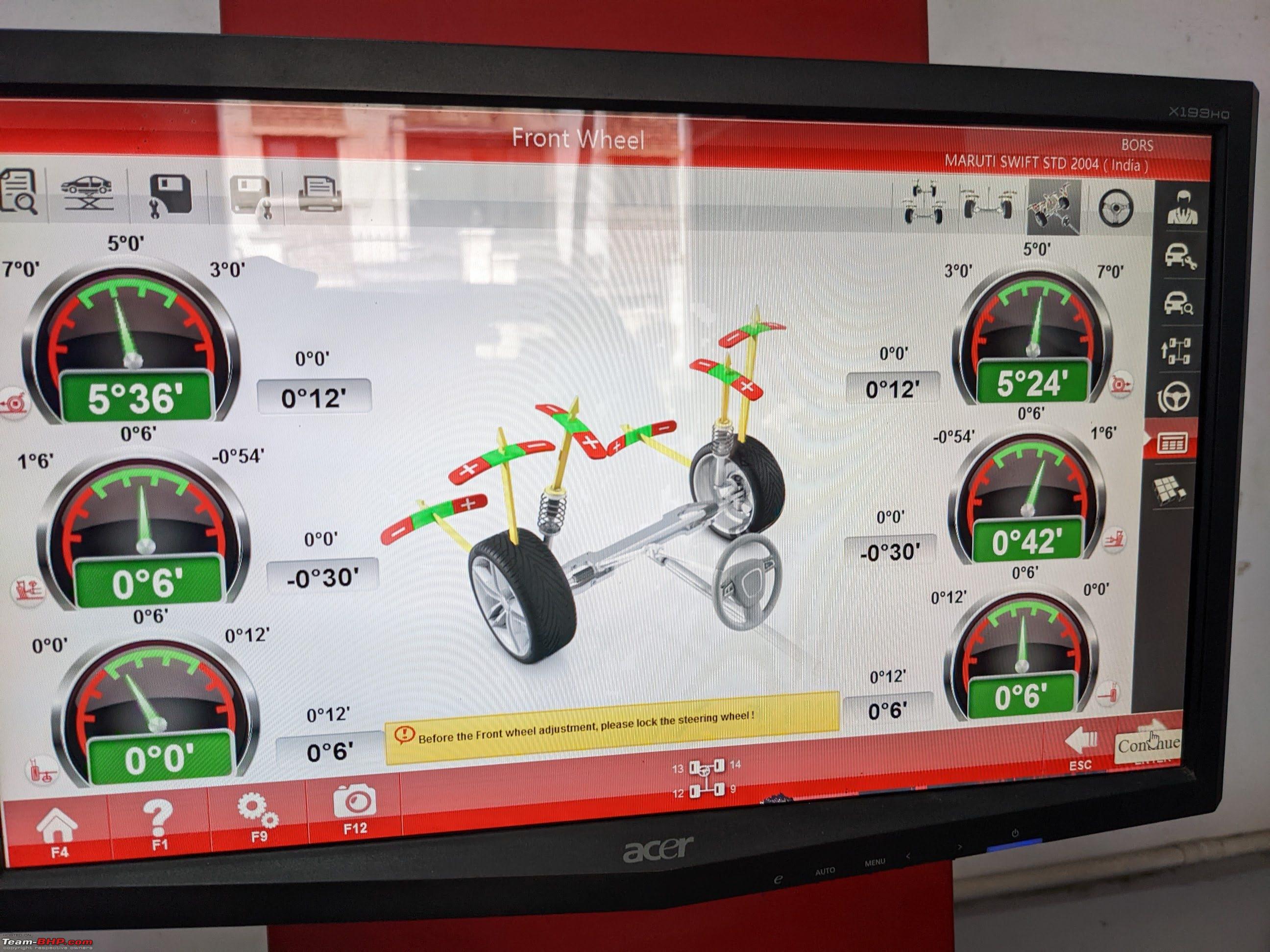

I recently got the wheel alignment re-done on my Swift P 2010 with 45K kms on the odo. I was too tired that day that I did not pay much attention to the readings. All reading were in green after the adjustment but one was 0.34 (green). Is it important to have all readings under 0.20?

I have been trying to get the alignment corrected after suspension overhaul but the car seems to be out aligned. I am attaching the most recent readings after alignment but the car seems to be going to the left a little now. The running is almost nil so hard to figure out perfectly since no road nearby is good. What (tolerance in reading) should we be pushing the technician to get a good alignment? Everything about Wheel Alignment: Post your queries here-pxl_20211214_084122606.jpeg
