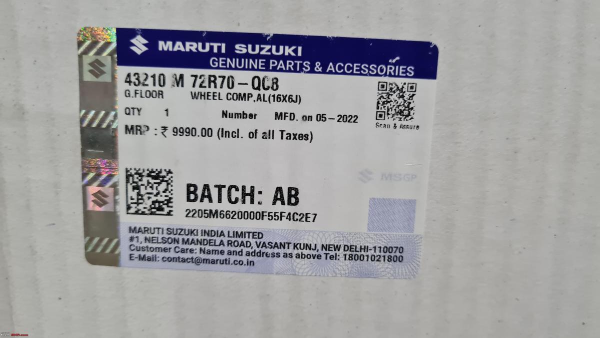

29th April 2022: Part number of alloys come out, and they are priced at Rs. 9990. Thus as per these details, just the tyre and alloys (5 sets) would cost me near Rs 1 lakh. The suspension part numbers aren't out yet.

20th May 2022: Surprisingly, the new alloys came in stock on Boodmo and I placed an order during their 12% discount weekend. Also used a credit card for extra cashback. Thus the alloys cost me Rs. 43,920 for a set of 5.
