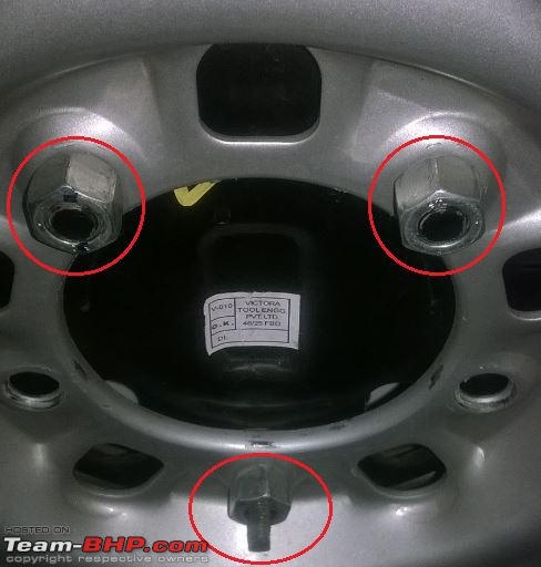

Are you sure about this? I did check on this aspect when getting the new spare mounted. The bolts are just long enough for the stock tyre and leave no margin for any spacers being put AND getting the nuts tightened enough.

Agreed. In which case, simple aluminium washers should do the trick. Let me check back on this once more.

Memory lapse; I see that just the bolt with a hole for a lock is long; the nuts are to the end of the other bolts. Even so, using some spacers may still meet both objectives. After all, the nuts on the spare aren't under the kind of stress that those on the wheels are, so even a nut that is partially engaged but fully tight ought to still retain the stepney well enough while the spacers allow for the indentations to not happen.
Yes, I double-checked yesterday and there is barely any margin on the two upper bolts to fix a spacer. If at all, spacers with less than half the width of the nuts can be considered but not sure if these will be wide enough to make any significant difference. Please see pic below...

I don't know what spacer width will totally eliminate the problem, and if that will leave enough thread on the bolt for the nut to be effective. However, even if the spacer is 50% of the nut width, it will reduce the amount of indentation which might be a good thing for the tyre, while still leaving enough thread width for the nut/stepney to stay mounted if the nut is adequately torqued.
All speculation; I haven't done anything on these lines.

Spacer at wheel will not work since bolts are not long enough. Which leaves two options.
Add spacer for the mounting clamp and push it out from door. Or mount the rim ulta and see if there is offset that will help avoid tyres touching (don't remember those stock rims now). If not get an alloy with slight offset

This sounds like a good idea and least disruptive of the lot, unless the bolts for the mounting clamp have the same issue Let me try this out.

Edit: How about doing away with the rubber stubs altogether? Will that cause the tyre to rub against the paint of the tailgate?
