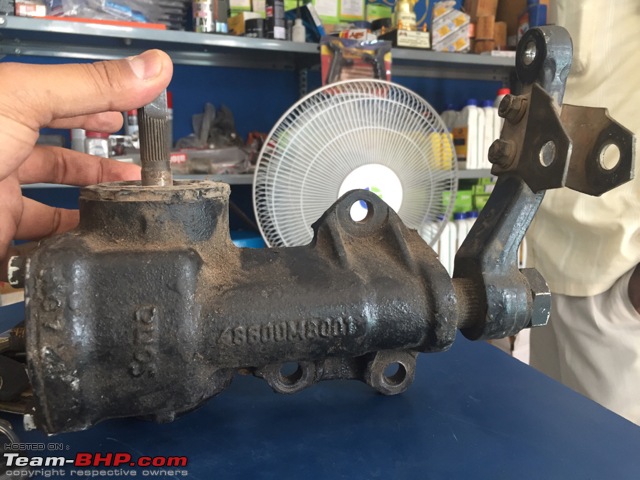

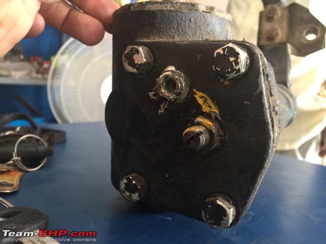

2. Steering box with king pin etc changed with a second hand one sourced by Nagaraju = much softer steering and much easier to turn and drive.

Here are a few pics - the old steering box and the Gypsy post car wash and so on...
