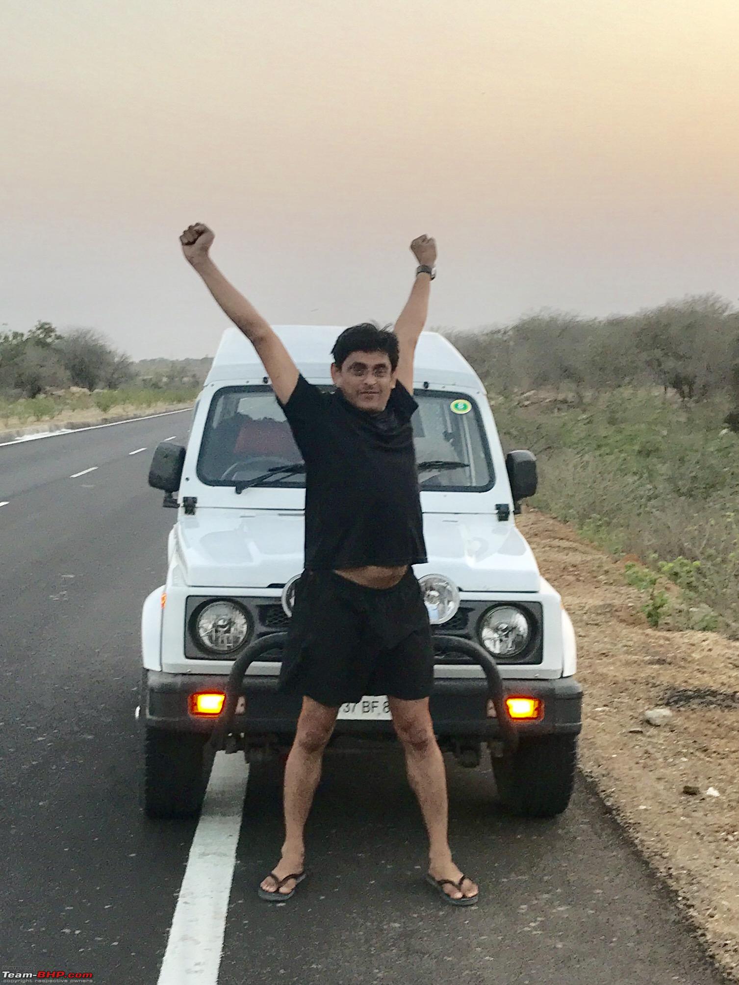

Dr. You still have your Gypsy right?
Yes , my gypsy still owns me and it will own me till it moves .
Recently did a 6000kms drive to Spiti valley with out any issues , my confidence on my gypsy is now even more stronger .

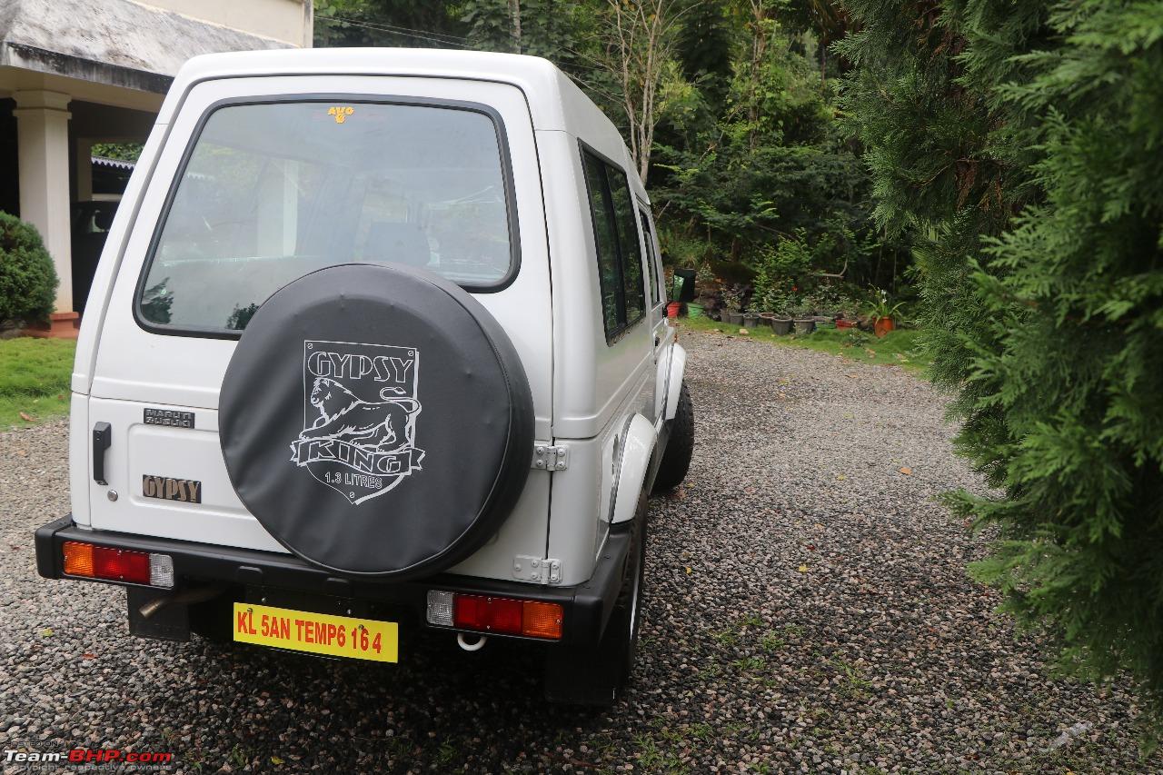

Dear friends,
took Delivery of my Brand new Gypsy King Hardtop last week.
Booking done on first week of November by paying 10000 rupees and delivery was on 24.11.2017 (after 3 weeks)
On road price: 7,45,000/-
can anybody suggest some good external rear view mirrors for gypsy. My car has only right side mirror and it is pathetic. Many people said Maruthi Omni or Bolero mirror will fit. Any other options worth considering?
