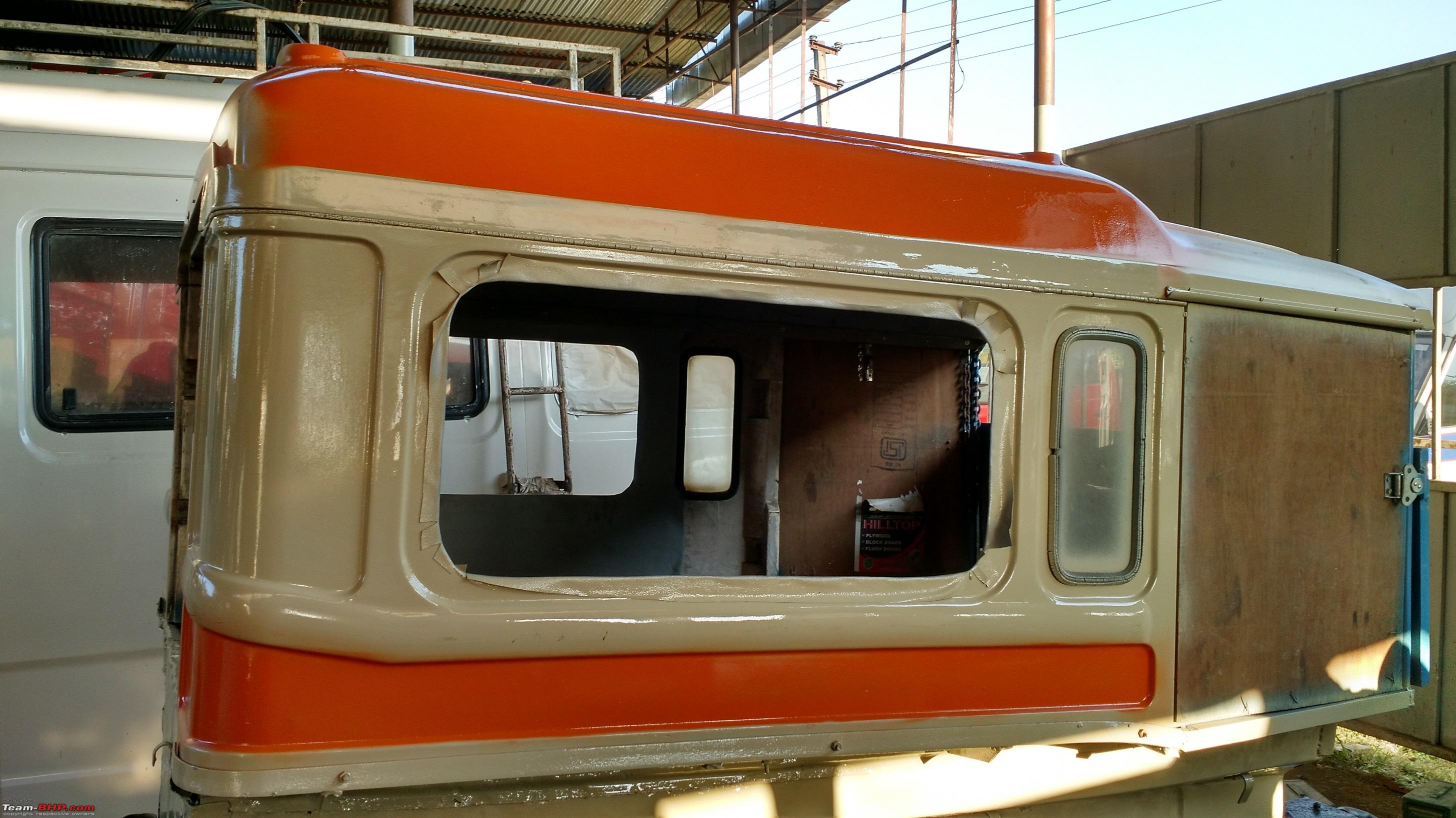

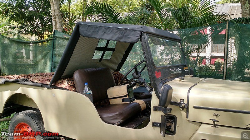

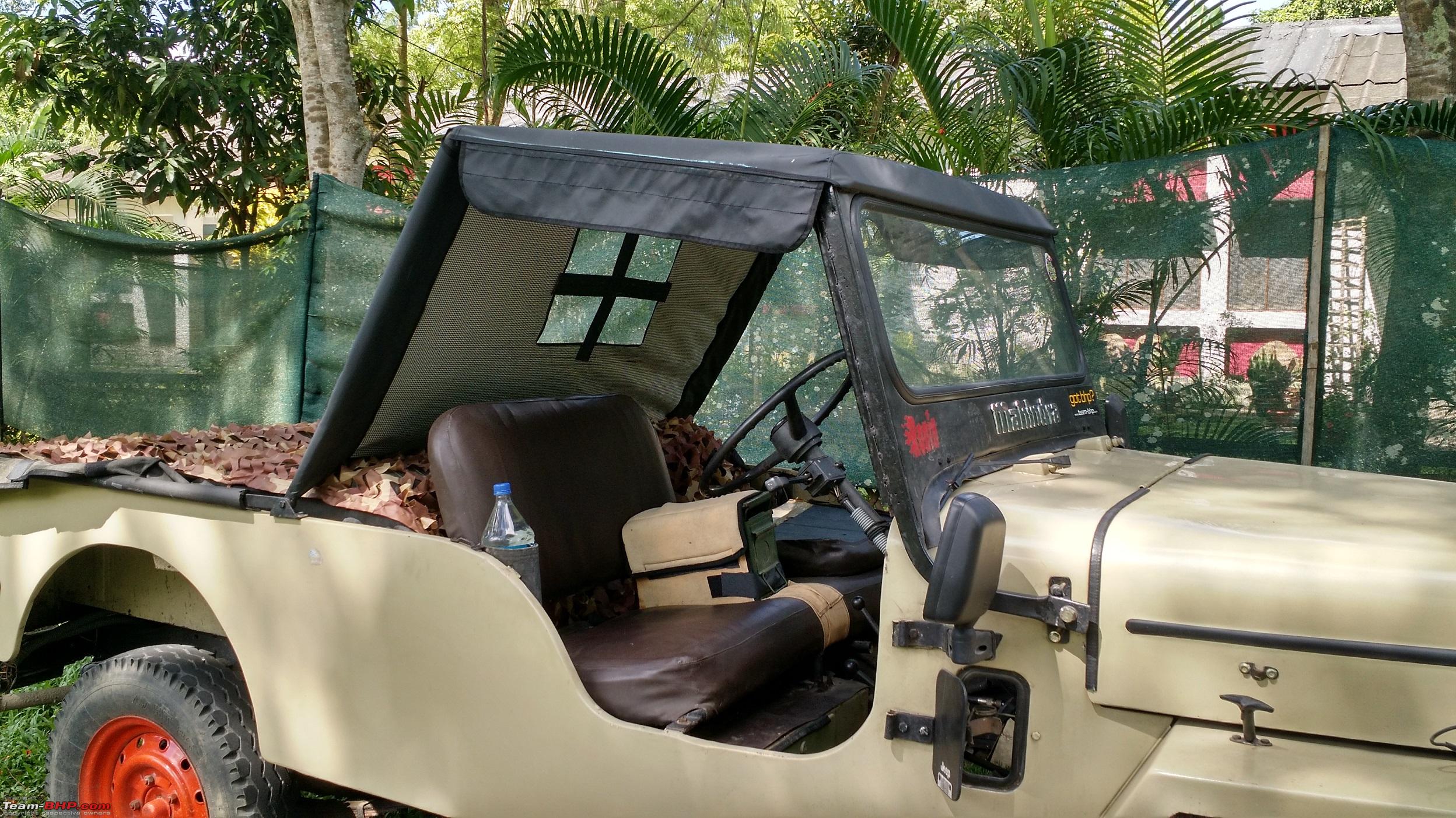

The Ronin went for a service and got all oils changed, hubs greased along with all nipples and a general top up. As a continuing work a half cabin top was made and installed. It continues to drive well and provide a lot of thrill. On the trailer front the interiors have been made and hopefully this weekend the front canopy tent shall be stitched and installed. I also hope to get the trailer wiring done this Sunday.
