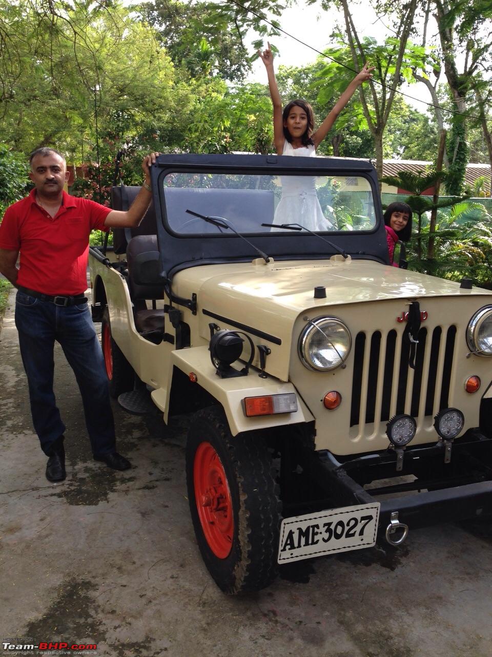

Finally the jeep has come home and this is how She looks now.

It has come out really good.
One suggestion - search for square side mirrors of CJ3B (replicas easily available in Mayapuri) to enhance the look. These Tata Ace side mirrors are spoiling the looks.

Dear Wanderernomad - you really went overboard but the end result has come out very good. Please change the number plates, they don't look nice now. Best of luck!

Thank you. It indeed means a lot coming from you. Just one query. Are the hood latch points on both left and right side equidistant? in my case the left hand ones seem to have moved further upfront towards the grill than the right side ones. You can see the latches slightly tilted in order to secure onto the holding bracket. I measured the distance and in the right hand side the distance from the hood end to the first hole is the same as the distance to the second hole on the left side. The sides are taken as sitting in the drivers seat.
