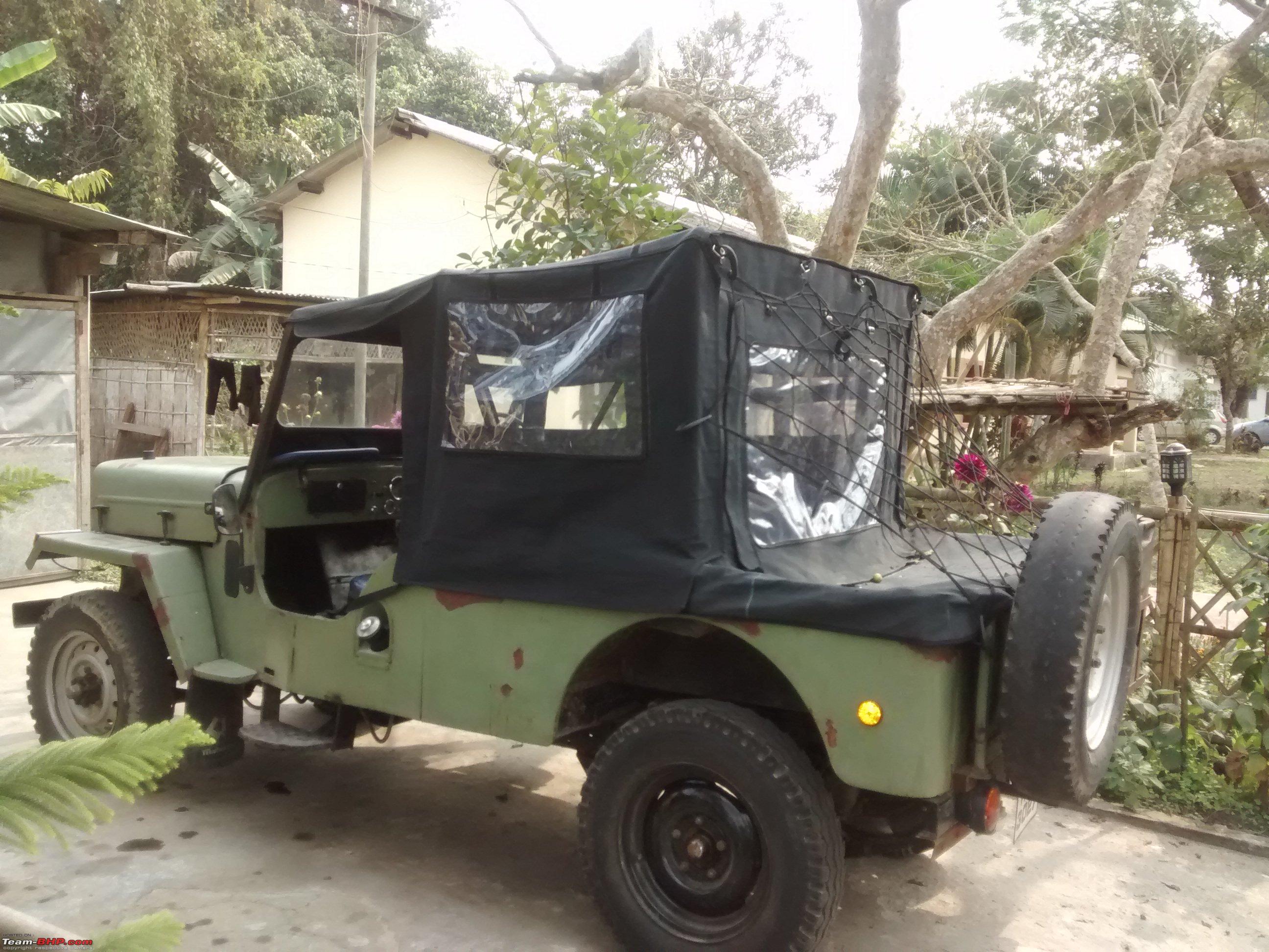

re: A Mahindra CJ500 DP and a custom made Expedition Trailer
Got the canvas top made today. The side curtains and the rear curtain can be folded and hung from the roof panel. The large mica sheet windows can be rolled separately even when the canvas curtains are fixed. Here are the pictures.
A Mahindra CJ500 DP and a custom made Expedition Trailer-camerazoom20150222150557732.jpg
A Mahindra CJ500 DP and a custom made Expedition Trailer-camerazoom20150222150839412.jpg
A Mahindra CJ500 DP and a custom made Expedition Trailer-camerazoom20150222150905893.jpg
A Mahindra CJ500 DP and a custom made Expedition Trailer-camerazoom20150222150921275.jpg
A Mahindra CJ500 DP and a custom made Expedition Trailer-camerazoom20150222151902794.jpg
wanderernomad is offline   (3) Thanks
Canvas works are over. Total cost came to 6500 INR. Now only a bikini top remains to be made to provide shade to the front seats occupants only. The pictures.
A Mahindra CJ500 DP and a custom made Expedition Trailer-camerazoom20150301095821945.jpg
A Mahindra CJ500 DP and a custom made Expedition Trailer-camerazoom20150301095831036.jpg
A Mahindra CJ500 DP and a custom made Expedition Trailer-camerazoom20150301095846506.jpg
A Mahindra CJ500 DP and a custom made Expedition Trailer-camerazoom20150301111331426.jpg
