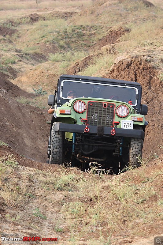

The hurricane engine was superb, i used 4L 1st gear and was crawling (this vehicle doesn't need any crawler set!). Engine was ticking away lil above idle and once in a while i would just dab the throttle to get me over the heavier inclines. I just love the effortless way in which this engine even with 3/4 output, preformed. Only the final climb out of the pit, i decided to use 4L 2nd gear for the momentum. The clay had dried up and the NDMS were powdering it and skidding away to the glory. Decided to do it in reverse direction and that also went smooth.
Issue no 1: Come out and open the hood for a customary check and i see that the radiator hose is tearing up! Thankfully its superficial but will soon need attention. Redliner shares his escapades with radiator hoses and i decide, enough is enough and lock the unpleasant site inside the bonnet.
Solution no 1: Get better quality hose, swift d intercooler hose comes to my mind. Its long enough, almost same dia, flexible enough and can hold temp well. Thoughts please?
