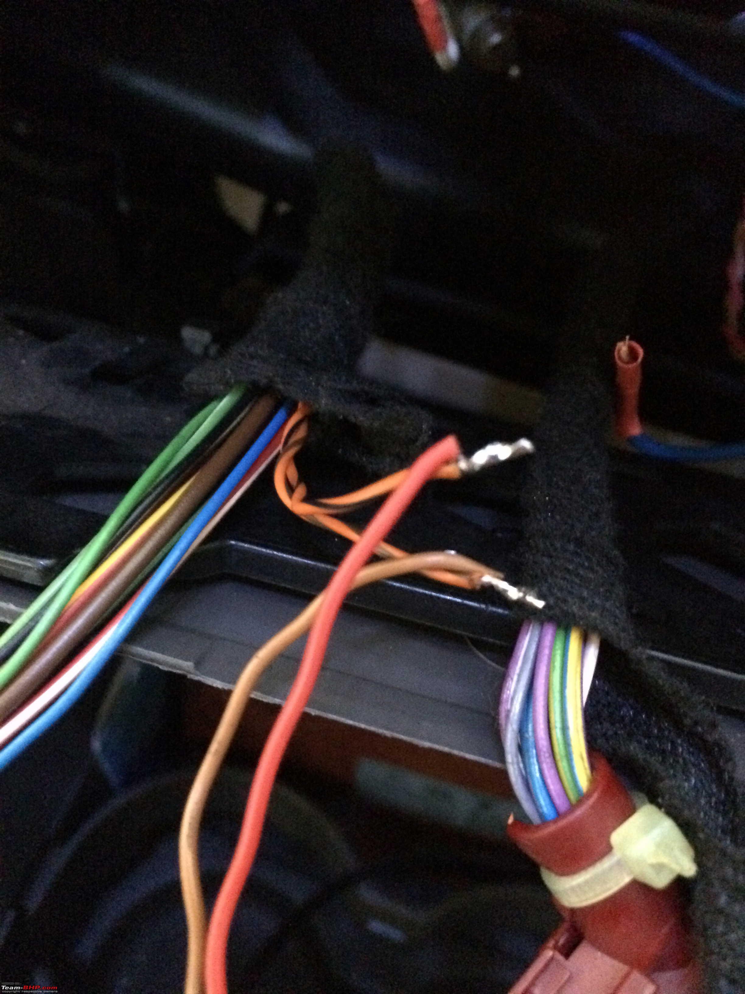

The next challenge was to tap the can bus from the car wiring. Trawled through the net and finally found solutions right here on Team BHP!!
http://www.team-bhp.com/forum/car-en...upgrade-2.html
and
http://www.team-bhp.com/forum/car-en...ento-polo.html
Tried accessing the BCM connectors and almost ended up with a slipped disc
Then I followed the instruction of member moralfibre and looked behind the climate control module and BINGO! there they were!! Orange with black stripe (can high) and Orange with brown stripe (can low)
Soldered two sets of twisted wires to the can bus (one rolled up stowed for any future use).
