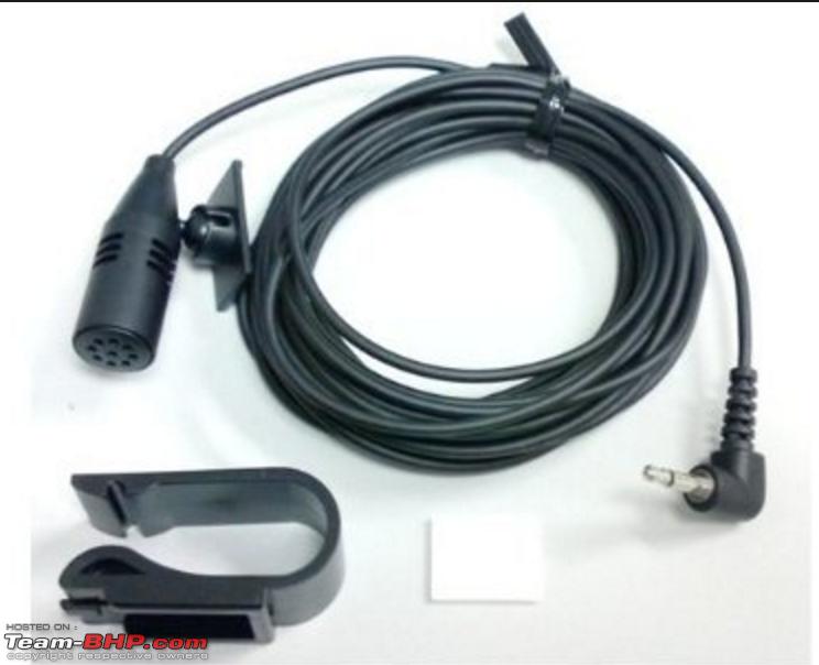

Have installed the following Pioneer Mic (Pioneer CD-VM1):
Name:  Screen Shot 20160103 at 12.08.46 PM.png
The quality of the mic is very decent.
Attachment 1456107
