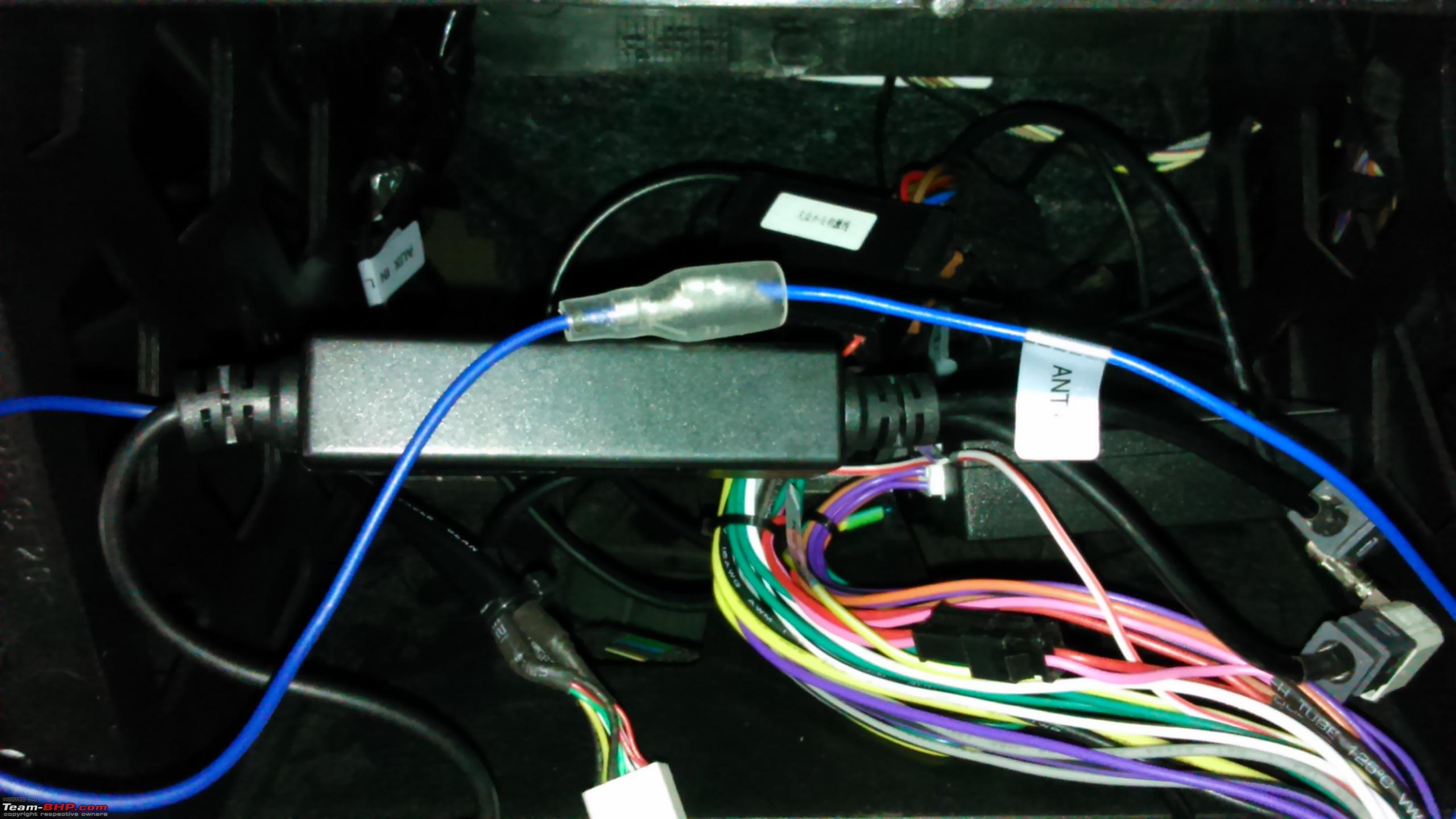

Those who are facing FM radio quality issues, please connect the BLUE wire from the FM Adapter to the BLUE wire (ANT+) in the main power cable.
This FM radio connector comes with inbuilt FM booster which requires 12V power. After this connection, FM radio quality is same like RCD320. I have cross checked the same with Seller also.
msiva75 is offline   (2) Thanks
Old 15th December 2015, 13:39   #75
frankmehta's Avatar
Posts: 4,029
Thanked: 3,668 Times
Awesome. This is just amazing. But i have very very good radio reception and it's possible my installer has already done the needful.
