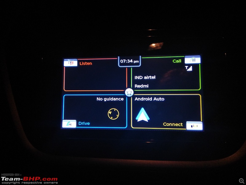

I had been to dealer for some other work. The dealer flashed 1750 file. It was successful in 2nd attempt. I have observed that 1750 version is much better than the leaked 1740. Android auto is working flawlessly. The dealer gets paid by Maruti for each car
(Rs. 329).
Android Auto update for owners of Maruti's older SmartPlay Infotainment System-img_20180110_122922.jpg
