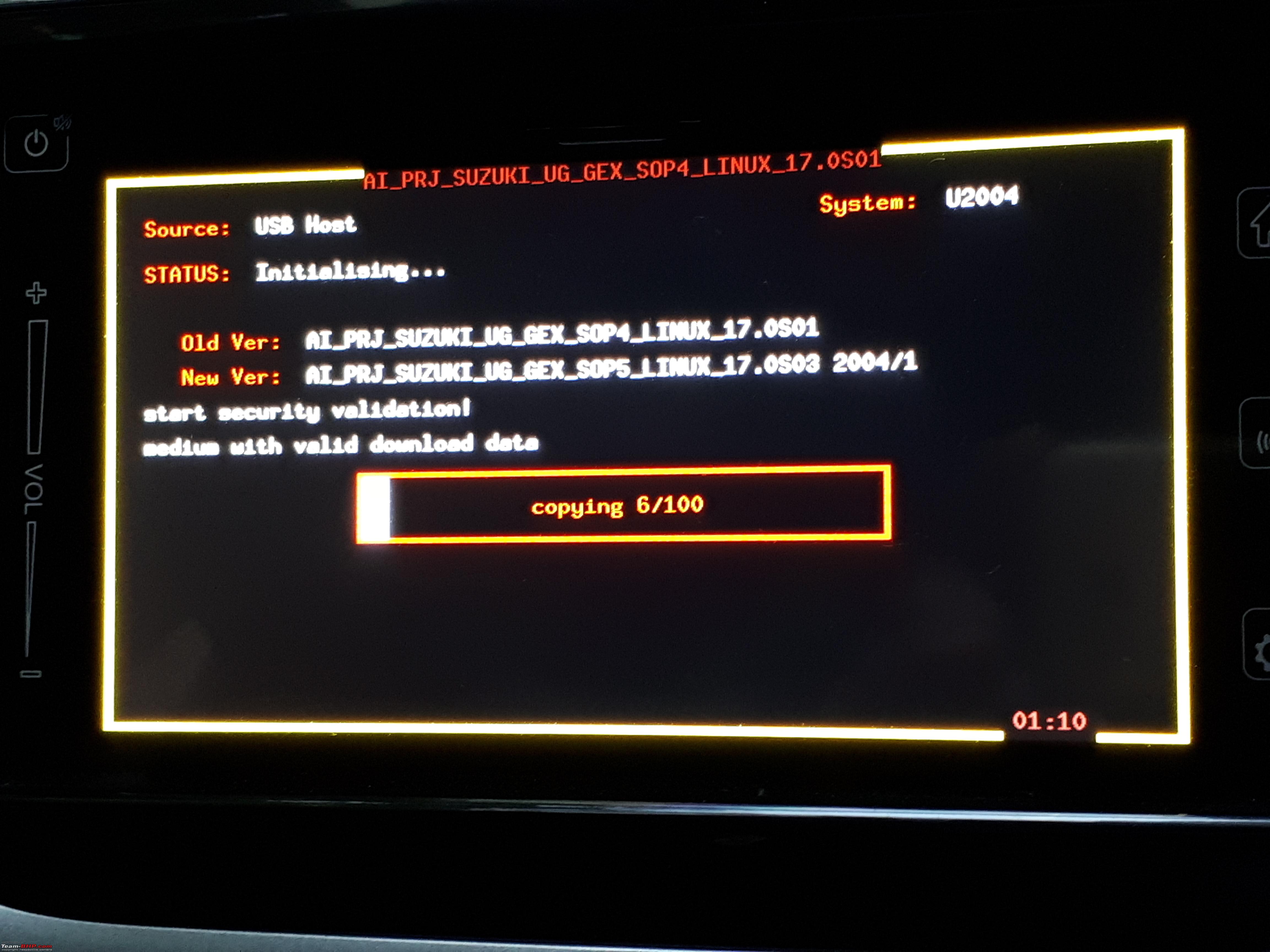

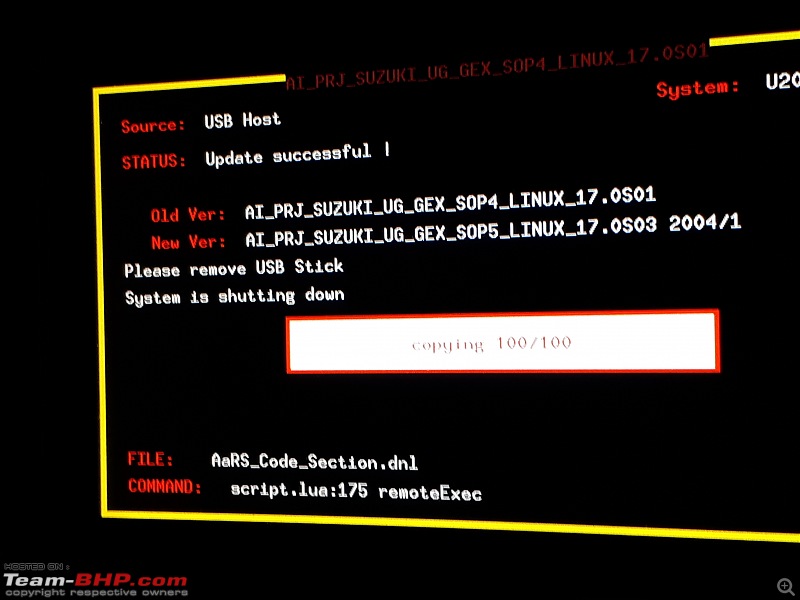

Did a successful DIY today. Files taken from the link above.
Android Auto update for owners of Maruti's older SmartPlay Infotainment System-pic-1.jpg
Android Auto update for owners of Maruti's older SmartPlay Infotainment System-pic-2.jpg
Android Auto update for owners of Maruti's older SmartPlay Infotainment System-pic-3.jpg
