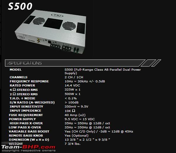

Specs of the TRU STEEL S500, from their website:
ICE Upgrade in Hydra's Hatch II (Swift Zxi) - Alpine,  Image Dynamics, TRU Tech-s500.jpg

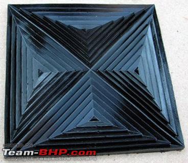

@KK, yes, as you said, there is way more control in the sub. This amp was really needed to round things out. The DynaXorb panels mostly help by diffusing the backwave of the speakers and thus reducing distortion. They also help a bit to cut down on the resonance transferred to the doors, working with the existing damping sheets. It is stuck onto the inside of the outer door panel, right behind the magnet of the speakers. Zuheimi'd bought a few kits for his personal use. Two got used in my car. It is a luxury, something that could have been done without, but hell, it helps a bit. Here's a pic of a DynaXorb square (not a pic from my install -- pic from Gunbir's Fiat 500 install), just for illustration:
