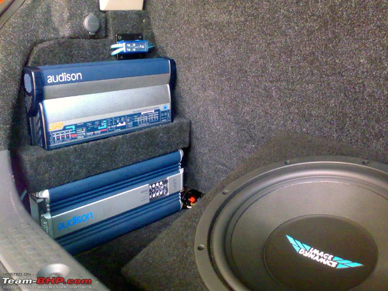

that woofer enclosure looks really tiny man.!
these ID subs have small requirements huh?
What sub are you running also whats the enclosure volume?
Yes, IDs are pretty good SQL subs and they require a relatively small enclosure volume. usually a .75 - 1.0 cuft sealed enclosure is known to produce fantastic SQ.
Yep, that's a 0.75 cu.ft. box. The IDQ12 is quite happy with that. As per specs, a sealed encl. can be between 0.55 cu.ft & 1.0 cu.ft., with 0.85 cu.ft. being the "normal" volume. I'd run the sub with a box that was just under 1.2 cu.ft. first, and then switched to this 0.75 cu.ft. box. With the current mono, this box suits my taste best.

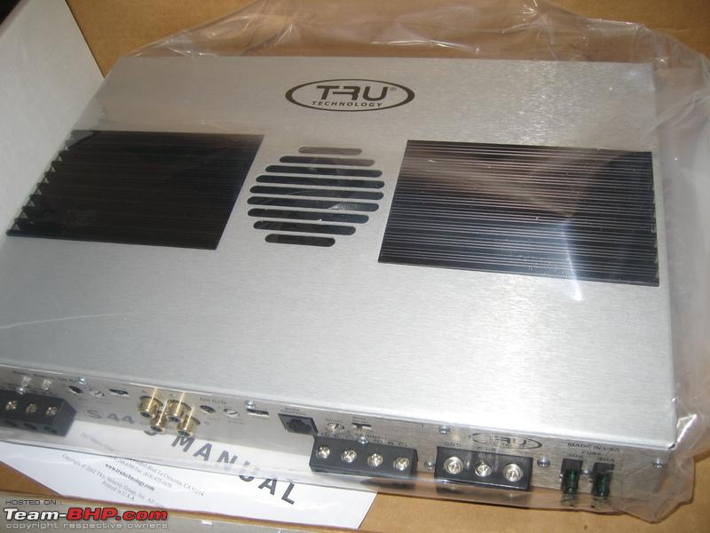

Coming soon:
ICE Upgrade in Hydra's Hatch II (Swift Zxi) - Alpine,  Image Dynamics, TRU Tech-img_1863.jpg
ICE Upgrade in Hydra's Hatch II (Swift Zxi) - Alpine,  Image Dynamics, TRU Tech-img_1864.jpg

Nice addition Hydra!
I am keen to read how does this amp performs in SUB section,Rated power for bridged channel in 200w,if i am not wrong.
Put it on,write a detailed before and after review!

Thanks, Gill! Actually, the sub section is something I'm a bit concerned about too!
Though the amp is rated at 65w RMS x 4 (or 65w RMS x 2 plus 200w RMS x 1) and 200w RMS x 2 in Dual-mono mode (both at 4 ohm), the amp has in output devices in excess of 1000w onboard.
I hope to have it installed in another 10-12 days. I will put in a before-after review once the install is done.

Nice Amp !
Have you installed it ?
When will it be up & running ?
I am sure it will sound nice;
Do post the pictures - post installation...
All the Best !!!

@B, thank you! Not installed yet. I hope to have the install done in another 10-12 days. (The amp is not here yet). I'll definitely put up pics
@JK, thanks! Your help will come right on time!

Was expecting this.. and here it comes. Congrats hydra. Now I think even a trip to Cochin just for audition is worth. Expecting detailed pics and reviews as always.

The tru tech amp looks hot !
Can your audison 4 channel be bridged into a mono ? If yes won't it deliver more power than the mono audison ?
