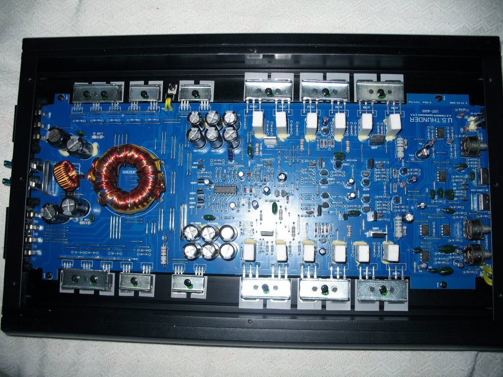

Souljah, the amps torroidal tranny looks kinda small and really poorly made. i gotta tell you a secret. about 50% of most amps budgets is just the power supply. that is what costs and this is where the maufacturer has skimped on this amp.

navinji, thats the transformer in last picture right??

ya it is type of transformer. normally transformer has a iron or steel core made of crc or cold rolled steel having a shape of E and I the E middle steam becomes the core and the out side are the outer side of the transformer. and the i fill in the gap off the other side of the E these type of transformer has a noise in them . when not properly made they produce hum noise......like the local made voltage stabilizer it uses this type of transformers and also genrate some amount of heat.....
the above one is torroidal type it has a ferrite core used and the wire is wounded around it.they produce less hum and does not heat as much as the iron core type and are very efficent.....
the small copper wire covered ring is the choke it is also made up of the ferrite core and it is used to filter out the noises and other stuff from the dc supply given in to the amp..
Rest navin ji will give more technical aspects also to make it more interesting and add some thing I have left out...

So would this mean the amps going to be sucking a lot of power?

normally at ideal state amps doesnot consume much power but when a bass note hits the current demand goes skyrocketing. but all comes into the picture how much the amp can handle.....the real juice comes out when there is bass track is playing with continous bass in the background not like the drum beats which comes and goes very fast but like the hip hop type .......
the toroidal core is used in the DC-DC converter....this DC-DC converts the car 12 vdc to the required output needed or as per the amp design required but the output is like this..... -24 , 0 , 24 vdc. there are three wires . the center one is the zero potential and if we take a DMM and measure across the middle and the side ones the voltage will be 24 volts and in the specifie polarity as mentioned earlier... but if we measure across the both ends then we will get 48 volts this is like the posotive and negative rails of the amp on which all the mosfets are connected.....
Exactly. The power supply. Soul, most "high end" amplifiers will have an oversized power supply with output capability beyond whats need to put out the rated output. Compare a 100w x 4 Alpine and a 75w x 4 Audison and you will understand that rated power isnt everything.
As far as this amp is concerned, I would suggest you use this only for sub duty as I dont expect great SQ from it. But it would do a decent job of thumping around your sub. We are finally going to be in Bangalore last week of this month. Will check out your install then...
