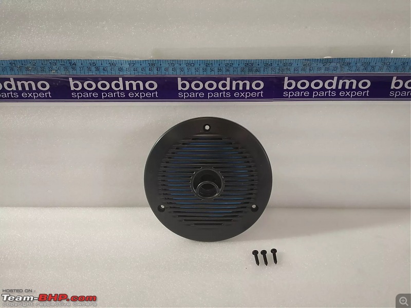

I have a 2016 Scorpio, with 6 inch speakers mounted on the rear door from factory. Recently, the plastic grill on one of the speakers broke, and so I would like to change both speakers out for something better. I have zeroed in on Infinity Alpha 6520F 320W and plan to do the installation myself.
I have a few questions regarding this and would appreciate some advice if possible:
1) The stock connector on the speaker harness looks like this:
Car Audio Advice from the Audio Gurus: Use "Search thread" before posting a new Q!-factory-harness.jpeg
On the factory speaker, the corresponding connector looks like this:
Car Audio Advice from the Audio Gurus: Use "Search thread" before posting a new Q!-speaker-connector.jpeg
Does anyone know where I can get a small harness with a matching connector to connect the new speaker to the factory wiring, with a blade connector on the other end to connect to the speaker itself? If not, what is the name of the connector I should be looking for?
2) The new speakers do not have any grills/covers on them. In fact I could hardly find any 6 inch speakers that come with grills/covers. There is a cutout in the door card which the speaker will fit into, it will not be behind the door card like on traditional car doors. Is it ok to leave the speaker naked? If not, where can I get matching speaker grills from?
The original speaker:
Car Audio Advice from the Audio Gurus: Use "Search thread" before posting a new Q!-original-speaker.jpeg
The new speaker:
Car Audio Advice from the Audio Gurus: Use "Search thread" before posting a new Q!-new-speaker.jpg
Many thanks in advance for your help.
