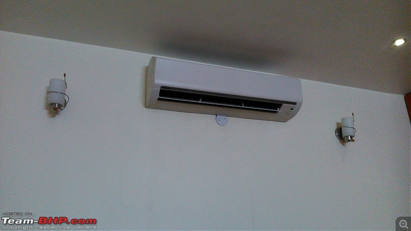

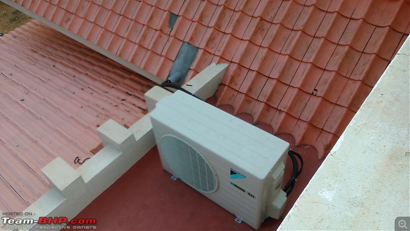

Thank you all for the brainstorming and great inputs. At last the AC has been installed and operational. After discussing with the builder, it was not practical to have the AC on the north wall with the existing setup, and hence that had to be abandoned. I will just cover the hole with a dummy plate or something and leave it. On the east wall, we tried to bring out the hole below the slab. But it was getting too low and would jeopardize the mounting of an LCD TV on the wall in the future. Hence, a hole was made on the wall and a matching hole on the tile structure and the pipe was brought out. Below are some pictures of the various steps.

Internal unit fixed.
The home / office air-conditioner thread-internal-unit-fixed.jpg
External unit fixed. The unit is now in a very convenient position for any future maintenance work!
The home / office air-conditioner thread-external-unit-fixed.jpg
One more issue to solve now. The water drainage pipe is too short and terminates just outside the PVC pipe. So, the water flows down the tiles and drips on the portico directly on my 10 day new Jetta
Have to extend the hose and take the water drainage to the extreme left of the tiles.
Couple of things you need to take care of -
1.) If you mount a LCD TV below the AC, the ac throw may cause condensation on it.
2.) The ACs tend to drip water from the indoor unit, if there is a blockage in the outlet pipe and this will fall on your TV - so position accordingly - maybe a wall mount that articulates a bit out from the wall.
3.) the water drain pipe needs to be at an angle to let the water flow downward - gravity - i had this issue after an experienced installer screwed up the angle and I found water suddenly pouring inside the room and around the place where I keep my laptop bag, HT speakers etc
BTW where is the stabilizer and the AC MCB?

1. The AC is quite high near the ceiling. If I set the AC vent to throw the air horizontally, would that cause condensation on the TV which is below?
2. Water dripping is one very big concern of mine as well. The reason why I had made provision for the AC on the north wall in the beginning was mainly to avoid this situation. Right now, I do not have a wall mounted TV. It is just a normal CRT TV on a stand. I will move the stand a little bit away from the wall so that any water dripping on the TV can be avoided. Will think of a solution when I go for a wall mounted LCD TV (no immediate plans anyway).
3. Yes. There is a small angle from the water drain pipe connection on the AC and the outlet, not much of a slope though. Hope this small slope is good enough to drain the water. Seeing the water dripping from the hose, I think the slope is good enough.
As this is an inverter AC, the dealer said there is no need for a stabilizer as the AC can operate over a wide range of voltage, and hence no stabilizer.
