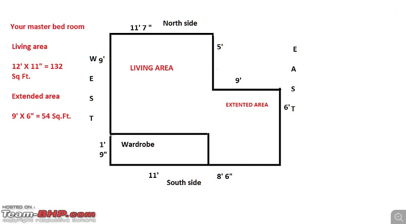

Thanks Guite. Below are the dimensions and rough sketch of the rooms I want to put air conditioners. I am fine for both inverter and non inverter models. What would suit me ideally considering an 8 hr run everyday for 10 months a year
Attachment 1571681
Attachment 1571682
8h/d 10 m/y is quite a long duration ~ 2400 hours. Even if you save a few rupees an hour an inverter will pay back very fast. 1.5T inverters will suit your requirement, a 1T will be too small.
Attachment 1571681
Attachment 1571682
For master bedroom 1 ton inverter AC should be fine and for the guest bedroom a 1.5 ton inverter AC will be good.
For 8 hours per day usage inverter ACs will save you substantial money in the long run.
A 1 ton inverter AC after attaining the desired temperature will consume about 200-400 watts per hour, where as a 1.5 ton will consume about 300-500 watts per hour. Half load for 1 ton being roughly 400 watts and for 1.5 ton being about 600 watts.
Attachment 1571681
Attachment 1571682
What is the extension part of master bedroom used for? You may not get cool air distribution there. You can use a pedestal fan to blow cool air there. Considering you have terrace above, 1.5 ton should be ideal; 1 ton may be a bit too small, it will get over worked. Moreover for 8 hour use per day, inverter AC will save you money in the long run.
There is a washing machine placed in the extension part. I don't want cooling in there but I presume the 1 ton AC will over work to cool it as well.

Forgot to mention that the guest bedroom usage would be around 150 days a year which would translate to 1200 hrs approx. Presume I would be better off with a non inverter split AC
Some of the AC models have a function called follow me or ifeel. In this mode there is a temperature sensor inside the remote which will relay it to the AC and control the temperature accordingly. You can keep the remote next to your bed and once that area is cooled it will slow down. And if you are still concerned about the AC over working 1.5 ton should suffice.
Even if the AC in the guest room will be used less frequently you will be better off with an inverter AC incase you feel like upgrading later on you will not get a good resale value.
It would be better if you purchased one 1.5 ton inverter AC first for your master bedroom and see how it works before purchasing the one for the guest room.
