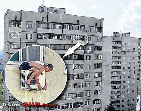

I am not in the market yet, but I am curious to know how can I install a split AC in my bedroom on the 6th floor , with only one window, and without a terrace or any other supporting platform nearby ? If it is to be supported by angles, how would the installation guy even get there, given the window is barricaded by a heavy grille and its quite dangerous anyway. I am a complete novice to this, so tried checking if anyone else in my apartment had ODU's hanging around, but found none. A couple of them had it on their terraces, if attached to the bedroom. Or do cases like me only require a window AC to be installed ?
Quick googling threw up images like these, which arent very encouraging..
The home / office air-conditioner thread-article0023a7cff000005dc37_468x368.jpg
