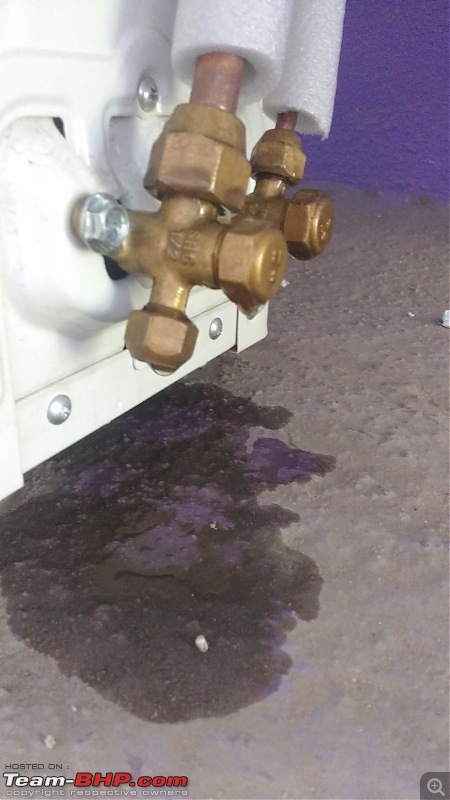

I bought a Whirlpool Magicool 3 star inverter split ac, during January. The ODU is placed on the sunshade of the window. For the past few weeks I have been noticing water dripping on the clothesline strung immediately below the sunshade. Humidity has been high in recent times. I thought the drain tube connected to the IDU outlet pipe must have become loose and went to check, but water was freely flowing from it to a flower bed where it is routed.
Surprised, I climbed up to check what was wrong. There was no water coming from the connection to the IDU drain pipe. But water was condensing and dripping from the refrigerant inlet/outlet pipes connected to the compressor. This water is falling on to the sunshade and after a while running off to drip on the clothes hung out to dry.
Any idea how to remedy this? Ac is cooling well, no issues. I have not seen this happen in the Samsung split ac I have in another room.

Does your Samsung use the same copper pipe insulation material? What appears on this AC looks like Styrofoam insulation which won't have the ability to absorb condensation on the pipe. What you need to use is polyurethane based insulation which can absorb water on the pipe. It is a much better insulation material too.
It is possible to replace the insulation material yourself. Will be a lot cheaper than calling an engineer just to do this. Approach an AC wares shop that sells parts and buy the length of polyurethane insulation material you need and wrap it around the copper pipe. Cut the new insulation material and wrap it around the pipe. Ideally; you want to slip it in like a sock but you cannot do that as the system is charged. Wrap the new insulation material around the copper pipe and use cable ties to secure the insulation material. Do not over tighten.
Do note that some water will still drip as even polyurethane has limited absorption levels. It should reduce a lot and not drip at the rate it is now.
The other alternative is to place a small tray just under the pipe, drill a hole into it and channel a small pipe else where so the water does not fall directly on your clothes line.

If you are worried about the water forming on the copper refrigerant pipe then worry not. That condensation is normal in high humidity areas. There is nothing wrong with your AC. It the same concept where water forms on the outside of a chilled container when kept for a while. The reason why it is dripping down is that the Styrofoam insulation does not absorb water.
