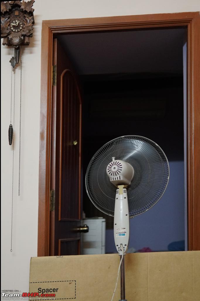

Bedroom AC, our old Daikin is showing an odd fault. It runs for a while (the first couple of times, it was for an hour or so, now it is for a few seconds) and shuts itself down.
... We hope to see [the engineers] at 10.00am tomorrow.
Engineer came as promised. He cannot bring a helper as more than one-on-a-bike invites trouble. He diagnosed fault with control board. He told us that both spares sources and board-level-repair shops are still closed, which is giving them great difficulty.
He took the board away.
He has returned early this evening, fitted the repaired board and all is well again.
We have labour-only AMC on that machine: cost of repair was Rs1,750.
I don't have to do this again tonight...
