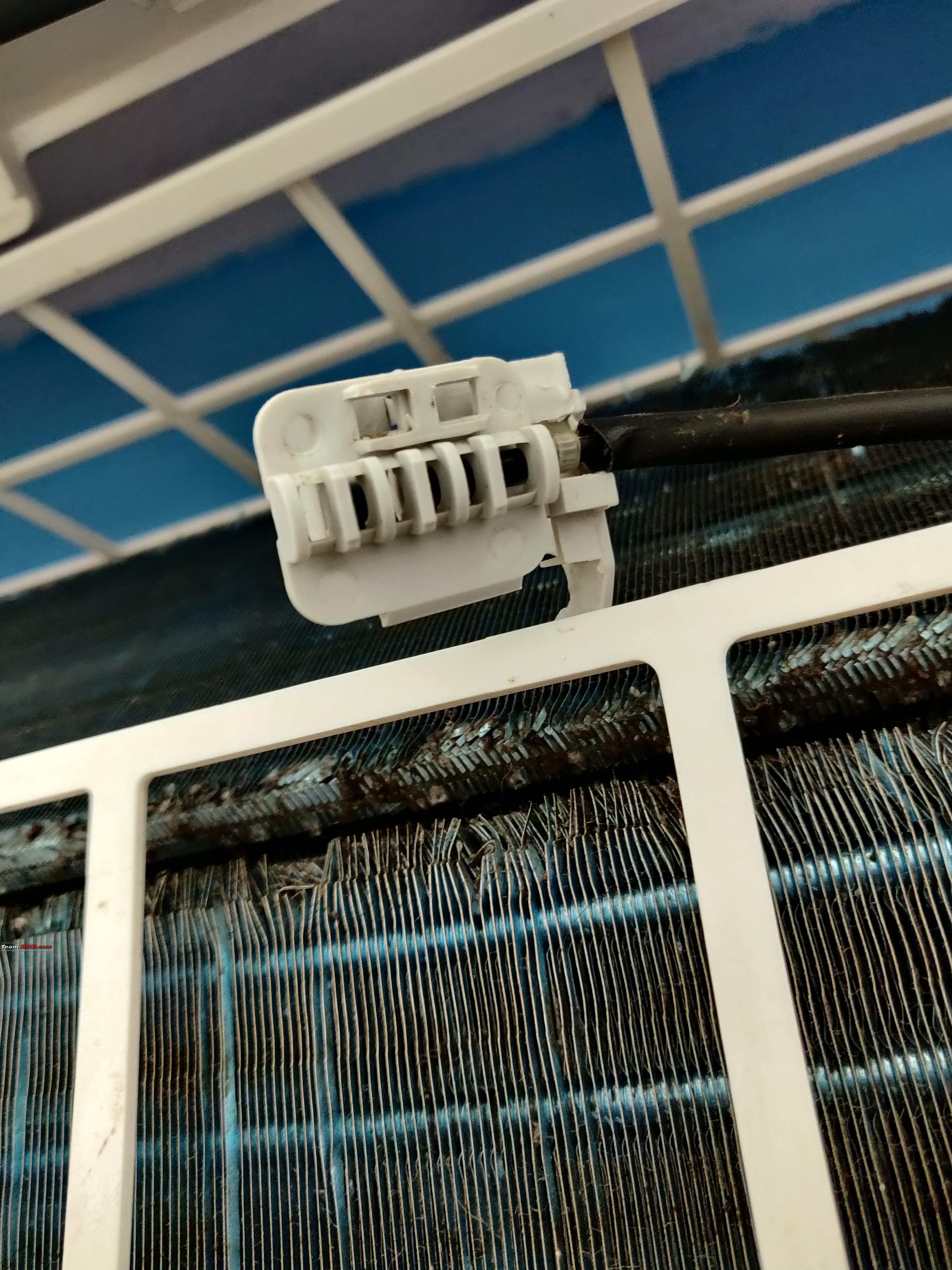

Noob question, is this the temperature sensor on the IDU? It has got a bulb. My previous AC has a different looking temperature sensor.
The home / office air-conditioner thread-img_20200611_114535.jpg

Few things you can try :
1) to clean the blower blades, stick a 1 Inch paint brush through the air vent (switch the swing off first) and let it rub against the blower while it is running. be prepared for a dust bath though! It will run off a lot of the dust collected on the blower. but I suspect that is not your major problem.
2) Your problem seems to be the Temperature sensor. There are two temperature sensors in a Split unit. One of on the Air intake part of the coil which measures the air temperature - this is supposed to be attached to the fins on the coil - in your case, this seems to have become detached from the fins - do clean the sensor and reattach it to the fins.
3) the second temperature sensor is mounted on the Evaporator coils themselves and is meant to prevent icing on the coil. This is quite inside and more difficult to access.
In your case, either one (or both) of your temperature sensors is faulty or very dirty. You compressor and ODU seem to be fine.
Thank you all for your help! That was really helpful as the AC is back like before. It nearly took me 2 hours to clean the entire fan with a paint brush.
From a mechanical engineer, I learnt that the blower will have a forward curved fan. The dust filled the curvical blades and made it a flat vane fan and so this happened.
And thank you for educating me about the temperature sensor and the fan! I cleaned the sensor and fixed it on the fins. That's the learning for the day!
