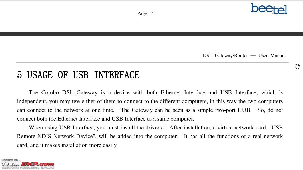

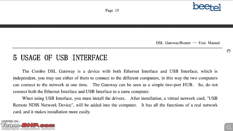

According to the user manual, Beetel 220BX supports both USB and ethernet ports simultaneously.
In that case, you can just buy any common wireless router from the market. Please, don't waste money on any specific wireless "modem".
First try attaching a wifi router to your modem. If your modem does not support USB while on ethernet, you could then buy a ethernet or wifi PCI card for your PC.
basic ethernet card costs around 150 Rs. and WIFI card around 750 Rs.

thanks for your reply. Could you be more clear, since i require a wireless modem to replace the old Beetwl 220Bx modem. So which model of wireless modem can i go for?

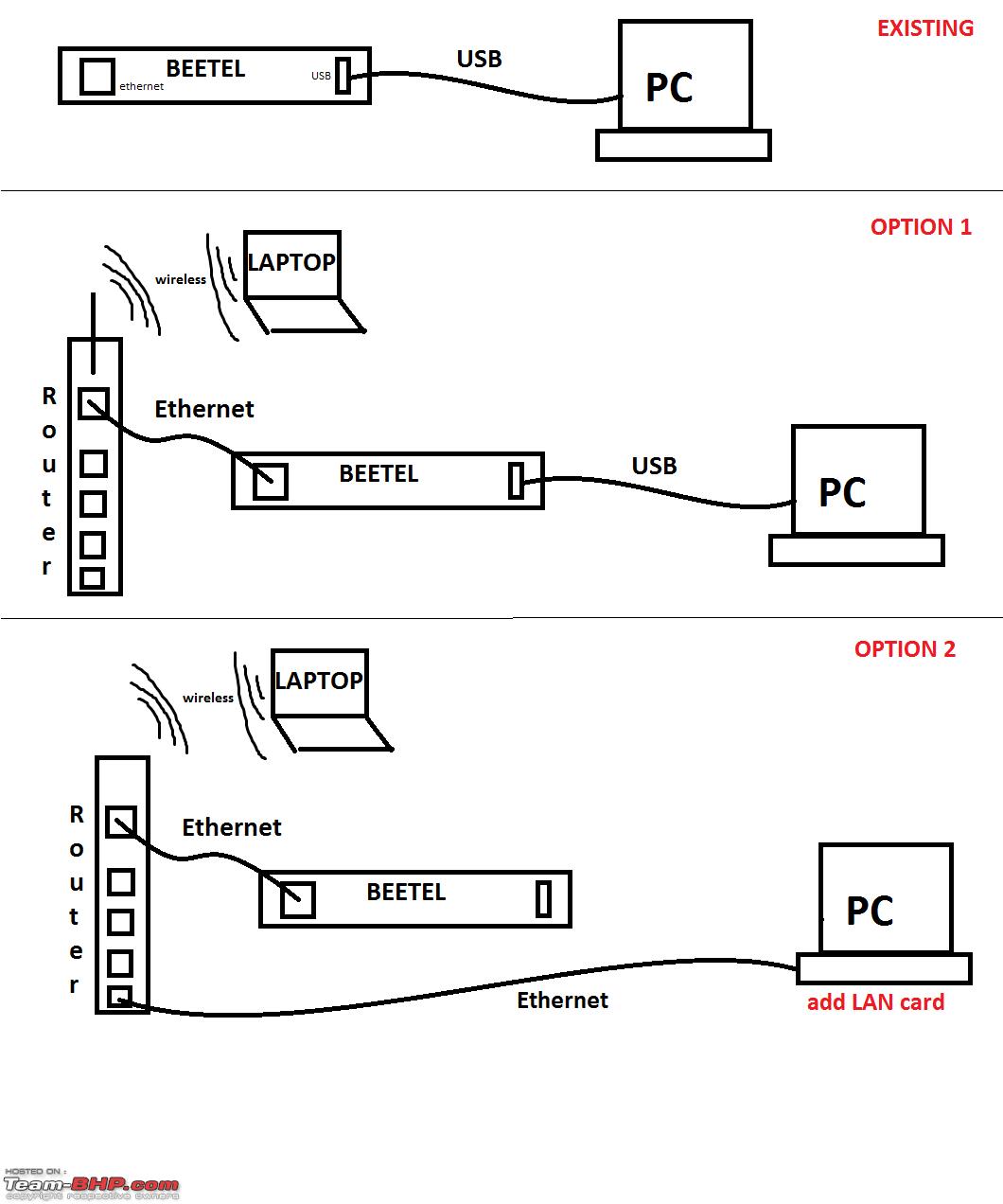

1. My suggestion, do not buy a wireless "modem". Continue using your existing beetel modem, and add a wireless "router" to the existing modem.
basic WIFI modem could easily cost 2000 Rs. while you might be able to get a good WIFI router for 1100/1200 Rs.
2. As for your PC with only USB port, you should be able to use the existing connection (USB to USB). If you are not able to use USB to USB, you can buy a LAN card (100-200 Rs.) for the PC and connect it to the new router.
3. WIFI routers are one of the most common commodities in the PC market. I am not aware what exact models are available currently. But, you shouldn't go wrong with the most common brands like Linksys or netgear.
