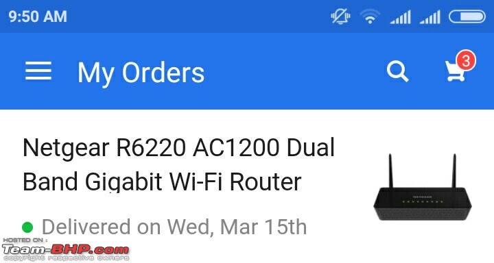

Originally Posted by Red Liner View Post
Could you please tell me which tp link router i should get? Humongous catalogue online.
here are three routers I purchased recently for some software product testing at work. The TP Link is being used at a location where there could be 10 to 20 people concurrently using it on a full time work day basis.
