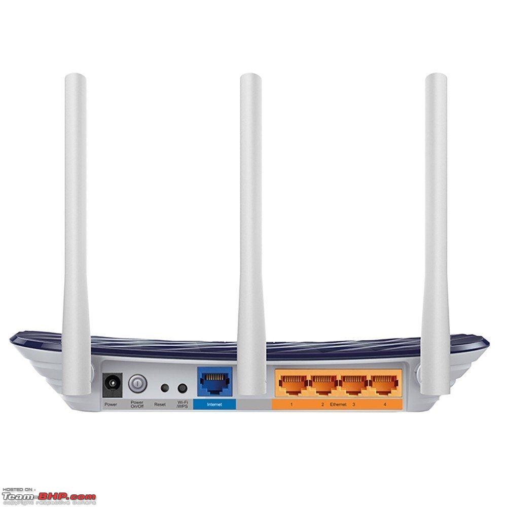

Hi, I thought Excitel broaband needs a WAN port which this TP Link AC750 doesn't seem to have. What am I missing? I'm also considering this router but not sure if it is compatible. Thanks.
All home routers have WAN ports. In this case check for the port labelled 'internet' that is a synonym for WAN. These ports are colour coded blue or a different colour from the rest to make it easy to differentiate. Normally routers have 4 or 5 ports in total, 1 WAN and the rest LAN
Basically, what R2D2 said. I have attached a picture (taken from Amazon's product page). The blue marked port is the WAN (internet) port.
