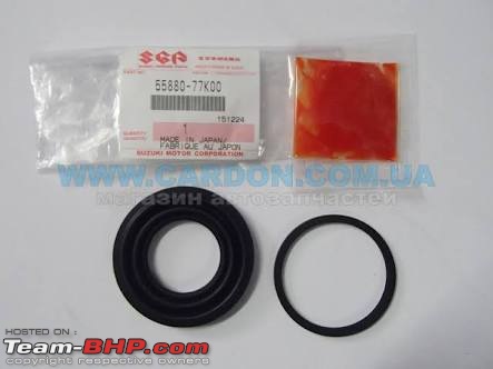

Originally Posted by Jaggu View Post
Seems like one of the rear cylinders is slowly jamming up in my Tara
It is the piston that needs cleaning/replacement. Just replacing the rubber bellow won't do unless, of course, the bellow is torn and water is infiltrating the cylinder and corroding the piston.
One of the rear pistons is getting jammed. After a 5 km drive with braking , you can feel the front wheel hubs(as a pair) , and the rear(as a pair) , to know which piston is getting jammed.
Just have that piston removed , inspected for corrosion, cleaned with brake fluid and reinstalled. You'll be good for over a year/one monsoon.
I managed one of the front pistons this way for over 1.5 years and eventually replaced it with a FEBEST 0776-GVJBF-KIT Front Brake Cylinder Piston
The OE piston seal set for the front is 55840-65j00. Rear piston for 2009 and later GV - no idea.
MODS : Please merge this with the above post.
EDIT:
I found that the 2009 and later(rear disc set up) GVs have this part number for the rear piston seal set - Rear Caliper Repair Kit, Grand Vitara, 55890-77K00 or 55890-77K01. Image attached for reference.
The part number for the rubber bellow and o ring alone (the minor kit) is 55880-77K00
Please verify.

Rear left is the one with issue, had done a clean up and it was fine till now. Today I noticed again it has started symptom. Unfortunately the outer rubber had got cut so thought of replacing the whole kit in all 4 wheels. The vehicle has been exposed to coastal area and the pistons are definitely not in best of condition, another reason to change.
Bingo! this is what I want the full kit. Thanks so much!
Styler & Vigsom you guys are awesome!

^^ If the other pistons and minor kits(bellow and o-ring)are normal, I'd suggest you let them be.
The rubber used in GV parts is very superior and won't go kaput that easily, even in coastal areas.
By the way, was the rear piston(the one that is getting jammed) corroded?
Yes the exposed part was pitted badly and the piston itself had lot of tough grime on it. Which I assumed would be fine with the clean up. Guess not. Another reason why I am prompted for full replacement is non usage. I also use the GV once or twice a week at best.
