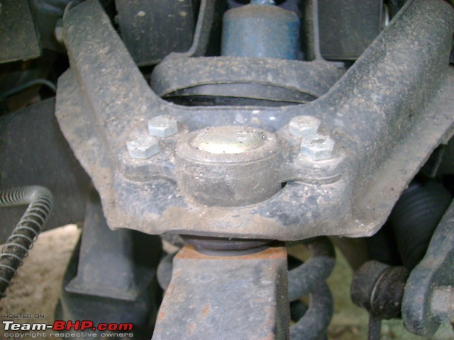

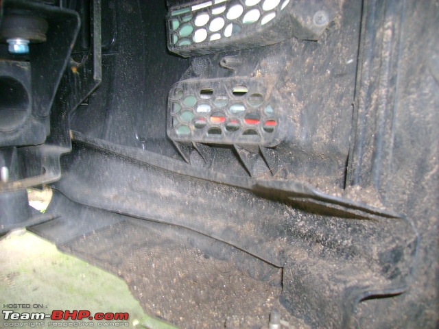

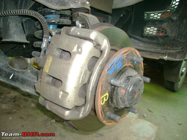

The Scorpio is performing its duty quite well for me and driving it is a pleasure. The engine and gearbox have become acclimatised lately and are maturing from the earlier "hard to operate" new feeling.The horn button is and will remain hard perhaps.Becomes a pain to operate at times in crowded places. It has to be pressed hard for the "horny sound". I wonder how people with some signs of Parkinsons or pain on the hand or even some feeble paralysis may feel, while operating this horn.
Meanwhile I did some DIY bits on the SUV today. Suddenly on the evening of 27th July there was some screeching noise of metal emanating from the front right wheel. Wondered what it could be? Was also scared so did'nt use the SUV yesterday at all. Today early morning, I tried to take it out of the garage but again the same metallic noise as and when the wheel moved fore or aft.
I traced it to the disc of the brake on the wheel drum and heard it again and again to confirm.
I had to forego my early morning jog and excercises. Loosened the bolts, jacked up the 1800 Kg Golaith and opened the wheel. The disc came out fully exposed. Moved the disc round and round. Its a rear wheel drive and the front wheels are free just like that!
To my utter horror, I found the thin metal dish that protects the wheel drum towards the axle, a bit kinked and rubbing with the hard brake disc.I am still curious to know what caused the kink to happen?Thats a great mystery as neither I had driven on any hard terrain nor did I do anything to damage the metal.
With some cajoling with the help of a heavy duty plier, the metal disc 9not the brake disc but the one protecting the wheel drum) returned back to normal and the kink went away. The noise was gone.Actually the metal is quite thin, with a lesser guage and can bent just like that. Or else, how could some simple manouvres with a plier straighten it? Quite a revelation, I feel! Need more feedbacks.
And some points about the jack and the tool needed to operate it. The jack is telescopic and has a long rod to lengthen it or the vice versa. The wheel bolt spanner also called the Tony bar has a slotted hole which fits with the end of the long rod. This whole assembly is operated to lift up the SUV. Now again I was horrified with the sight of the point on the SUV's body where the jack has to be slotted. Thats just behind the front mudguard and is the nut/bolt of the body bolted with the ladder frame chassis.Below this nut/bolt the jack is slotted. I find it extremely risky if the ground is uneven, as the SUV can simply slip and fall, injuring the men at work. Really miss the old Ambassador/Landmaster/ Fiat rectangular slots on the underbody, that used to snugly fit the jack!
The wheel disc
The kink to the right of the disc brake
Dirt on the inner of the front bumper
Rust on the axle end
The telescopic jack
The risky jacking point on the underbody
Full view of the wheel drum assembly
The inner of the front mudguard- The lower end is well protected with thickening plastic (of questionable quality??)
