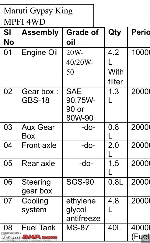

Clean out the engine oil by all means - the compression test done is a good sign. Leave the additives alone for one or two fills and just fill with that hx7 shell semi synthetic I told you about.
Do the scheduled service required as well.
Then take it on a few highway runs of 3-4 hours one way. Much better medicine for your Gypsy than all kinds of additive treatments.
Like old muscles which need a workout.
Actually what we are doing now is a full servicing. Starting with a clean slate.
Better.
It’s slow work but better done with care than otherwise.
Once they open the engine to peer in, we’ll see the condition of the “carbonisation”. And clean the throttle body thoroughly as well as clean out the blackened engine oil (looking at the dipstick the oil is indeed black) which means it needs a healthy fresh dose of clean oil.
We are also draining both the main and 4WD gearboxes as well as the front and rear differential oils and putting in the Shell Spirax SAE80-90 gear oil. So as to give the Gypsy a fresh start in many respects. I had bought 6 litres of these oils, which should be enough as per the workshop manual recommendation. Plus we are adding the “smoothening agent” - Xado Paste for the 4WD gearbox and Liquimoly for the main gearbox. So as to help lubricate the systems better.
Let me talk to the garage today and see if indeed we can put in some semi synth instead of fully synth.
Since the garage owner is a rallyist, he does know about these Gypsys. And I ve already bought the synth oil and Xado metal conditioner additive.
So I ll take a view after discussion.
