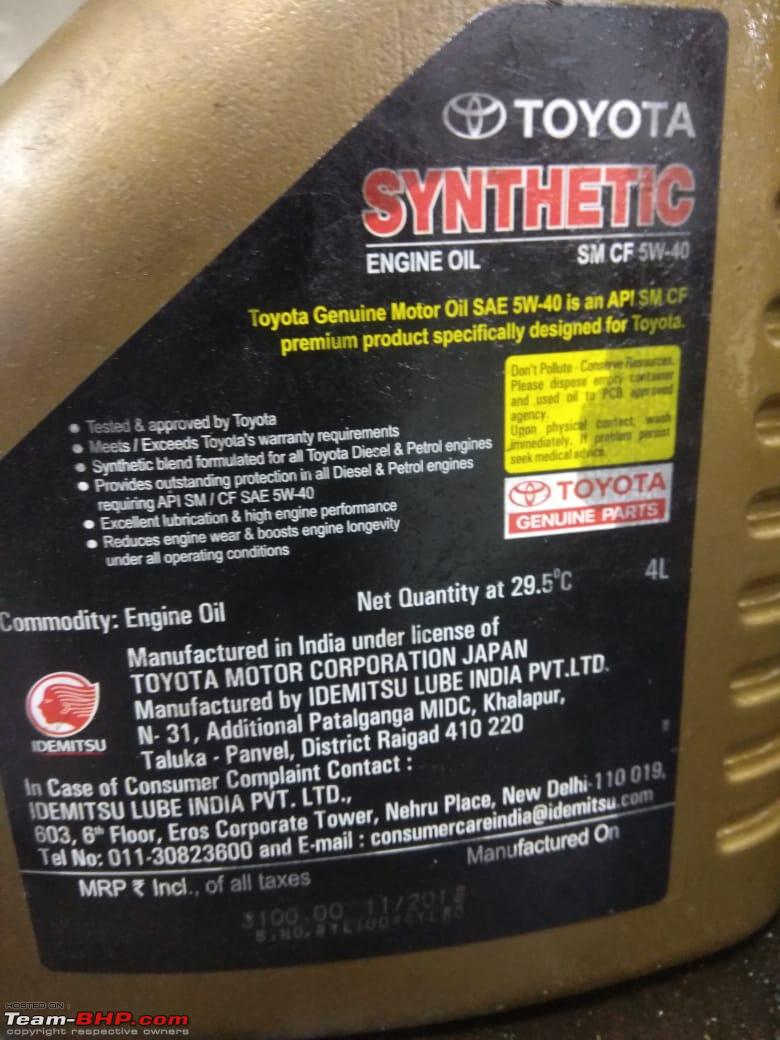

This is what Toyota uses, Synthetic costs about 775 per Ltr and regular one 325 per Ltr. Apparently they have shifted to 5W30 in case of normal oils whereas they use 5W40 in case of Synthetic.
Both are the wrong choice of oil for a Landcruiser is what I suspect. What does your manual for the vehicle say? Or there should be a sticker on top of the oil sump saying xWy oil only.
Given this is a 4.5 liter diesel you could just use a good heavy duty diesel engine oil and get much better results than these two toyota specced oils, which are anyway super old wrt technology (API SM/CF).
What makes you write that both these grades are wrong?
Manual mentions 5W30, for Colder climates like USA, Canada they recommend 0W20. So I am not sure if choosing 5W40 can be the reason for smoke?
TKM might protest. So let us do a bit of research on the grade they actually specify vs the grade TKM seems to be randomly filling, before he buys other oils.
Dealers don’t fill randomly. They go with what TKM tells them. But it will be interesting to ask them the reasons of using 5W40 in synthetic against 5W30 in normal. Wish Toyota guys were more helpful and they could have shared what did they originally filled when shipped from Japan
So you need at least API CF4 or ACEA B1 in that 5w30
I'd say just go for any 5w30 or 5w40 CI4+ onwards - Mobil Delvac 1 or Amsoil have 5w40 CK4 (which is backwards compatible to CF4) so should be fine.
What they are giving you is a low viscosity and HTHS but obsolete spec ACEA B1 / API CF4, but for such a powerful engine and using such crap fuel it is a matter of time before your engine starts hating on such oil. And besides the oil they're filling in India is made in India under license from Idemitsu, so who knows whether the manufacturing quality is a little iffy compared to Japanese oils.
Note - from the API specs -
ACEA A1/B1 Category is removed with the ACEA 2016 Oil Sequences. From ACEA 2012: Stable, stay-in-grade oil intended for use at extended drain intervals in gasoline engines and car & light van diesel engines specifically designed to be capable of using low friction low viscosity oils with a high temperature / high shear rate viscosity of 2.6 mPa*s for xW/20 and 2.9 to 3.5 mPa.s for all other viscosity grades. These oils are unsuitable for use in some engines. Consult owner manual or handbook if in doubt.
So the alternative is use a good ACEA A5/B5 (which is what updates A1/B1) in 5w30, plenty of those available too. Mobil 1 ESP for example, or Amsoil Signature 5w30.
Thanks, so where do you read these characters on the labels I posted?
But Toyota won't let me order Japanese oil and I cannot use my own oil. Perhaps, I can ask them to charge for the oil and keep that Oil for some other cars and instead use my own Oil on LC. Which brand and exact type should I buy in 5W30 ? Like these - Mobil 1 ESP for example, or Amsoil Signature 5w30 you suggested or are their some more premium options?
Normally black smoke from a car
It's more of a norm with all LC-200. The posts by Shivjeet explains more. I have observed same in Demo and Company cars. So nothing to do with a particular Car.
I believe the quality of Toyota OEM oil should be just as good as its equivalent in Japan. TKM would take pains to ensure that suppliers meet or exceed their standards.
For some reasons, call it whatever but I don't trust them fully. No reasons or anything to prove otherwise.
As for the oil stick to Toyota's mineral (5W-30) or synthetic (5W-40) only during the warranty. Once you have completed the running and it is due for the first service you could treat it to Toyota's 5W-40 synthetic assuming this grade of oil is specified in the manual
I have asked Service guy to check on availability of Synthetic 5W-30 as 5W-40 is no where mentioned on the manual or Internet.

Thanks, so where do you read these characters on the labels I posted?.
That slide with the technical specs you posted has it on the bottom line.
