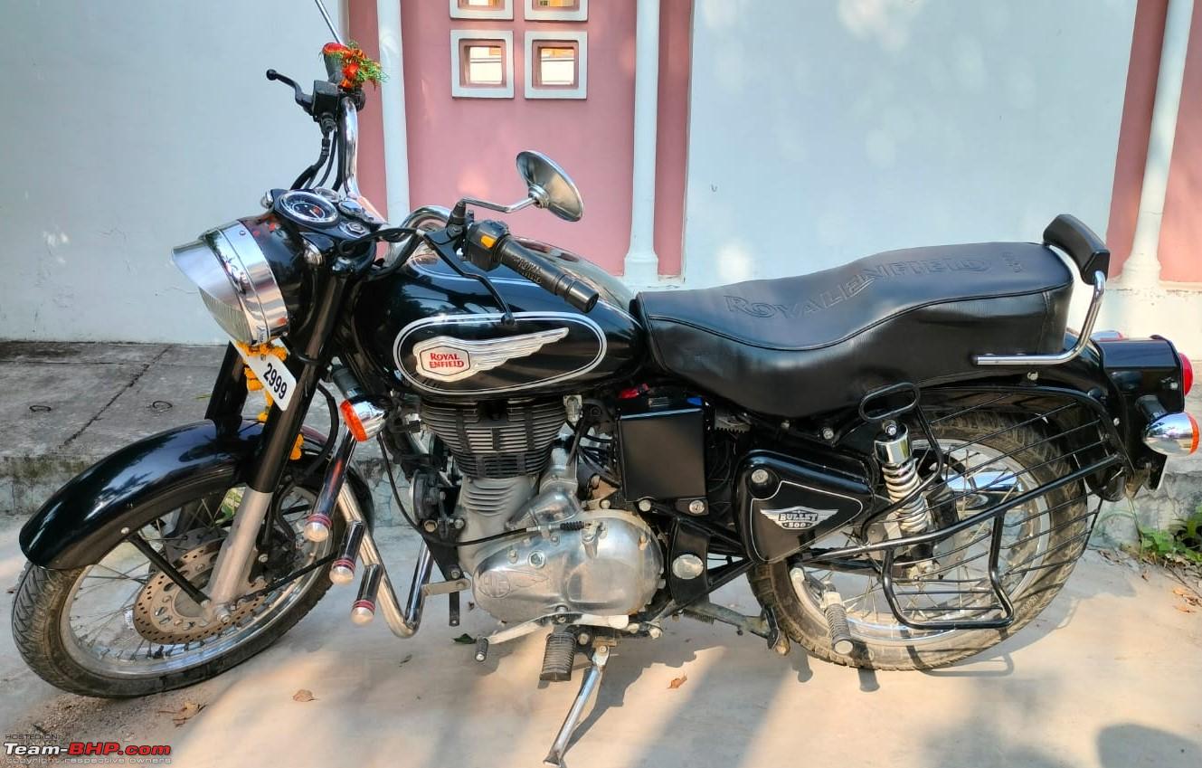

And I ended up getting one . Majumdarda, yes, I was searching for a less run, well maintained Bullet 500 standard since a few months after it was discontinued. Finally my search ended a couple of days ago.
Here is my Bagheera
Everything is just about prefect what I was looking for - a carbureted model (October 2016), very less ridden (just 8500 odd kms in 6 years), owned by a govt. servant, no modifications done, everything in stock condition and well maintained, new battery, no unwanted sounds, nothing in loose condition, from my neighboring district so easy ownership transfer (process initiated), and very gentleman 1st owner. What you see in attached pic is the bike in, as it is, condition, just got washed and handed over by the owner, no polishing etc done. It runs super smooth, gear shifting is butter smooth and finding neutral is also very easy.
On the day of purchase itself, I rode it about 100 kms to take it home at Lucknow, and already enjoying the torque and throttle input. Cruising at 60-80 is such a bliss on it. I seem to have got good hang of it in a couple of days, though never rode any RE or heavy bike except for TDs and Bagheera is 3.1 times my weight .
Detail experience and ownership report will come later once I put a few hundred kms on it.
One thing I want to do is to change the engine oil, no matter what the owner informs. I will go through the owners' manual too in next 2 days. Therefore, for the time being, will be grateful if you could pl. inform me which synthetic oil to go for?

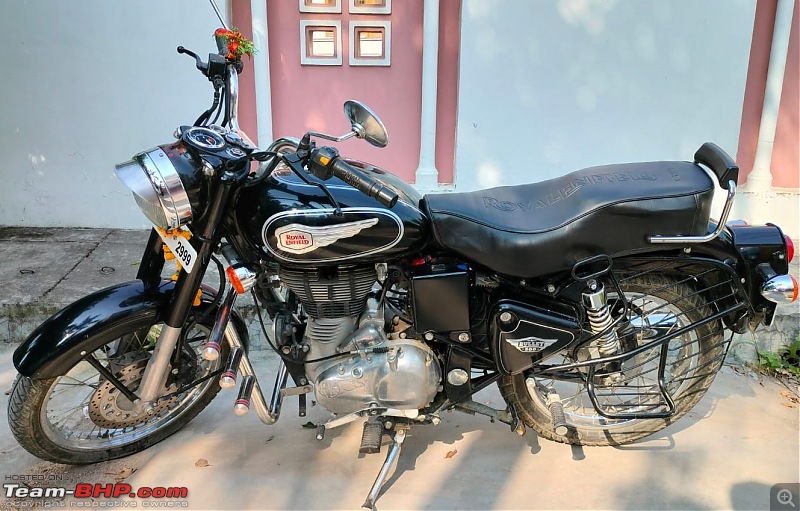

Congratulations LongDrive lover and very soon you will be proudly calling yourself a sedate LongDrive rider. Welcome, Bagheera to the Cult of B500 owners. If you love tinkering with the machinery, try to get hold of a Spare Parts Manual as well, the more recent it is, the easier it becomes to relate for we novices. With just 8500kms on the odo (i.e. approximately 1400 kms per year), it seems that your bullet was hardly ridden. Happy for you to be able to procure this gem, but I wonder why the original owner sold this off so soon?
In terms of engine oil, I still stick to mineral oil, preferably Motul's. Yes, I understand that I have to change the oil sooner than later; and that works out expensive if I compare it with the Synthetic oils (just in the aspect of multiple changes required and additional cost). In fact, before my Ladakh trip, I had put in new oil and drained the same post return. I will again change before I go to Goa, in November. In regards to the scope of synthetic oils, I believe, that we do not run our Bullets in "harsh conditions for extended periods" and neither we go mile munching on a regular basis. Moreover, if one still chooses to reap the benefits of an engine running on synthetic oils, it's just not the oil alone that gives thy satisfaction, but other components which are expected to be updated as well. As far as I am concerned, I am still sticking with the minerals.
Well, just one picture does not do justice and that too with a RE embossed seat cover. Probably you can try the old look by removing the seat cover and see if that suits your taste. Also please advise what is that metal thing hanging around. Did the owner have a bash plate kind of stuff attached to that? If Yes, then why was that removed?
Actually, I am quite opposite, meaning very poor in any DIY tasks in machinery, but yes, very good in gaining knowledge and getting vehicles serviced and maintained on time, even if the running is very low. I have a Safari DICOR 2009 model with over 1.13 lakhs on odo, first love of our whole family, that look and run like a charm and everyone, including mechanics get surprised when they hear about its age. So, yes, will try to source and get the Parts manual. Any pointers to its source are welcome pl.
Because he is neither a team bhpian nor an enthusiast Jokes apart, he is posted at a different city, comes home on week-end, no time to ride it. We (me and son) spent lot of time at his place (4-5 hrs), had detailed talks, saw his circumstances and were pretty sure of everything what he said and how it reflected around, were connecting. When he brought it, he was posted in nearby city and thought of using it for leisurely commute. Infact, he went to get 350, but showroom owner asked him to test ride 500 too after 350, and who will not get blown away with this torque power house! So he bought this. Now, his idea was that, as he is not able to use, and its resale value would go down further as the years pass, that's' why sold off now. Hope you got it now! Like any common man, it was just another bike for him, and fortunately he got someone like me for whom this is a rare gem, getting extinct
In terms of engine oil, I still stick to mineral oil, preferably Motul's.... Moreover, if one still chooses to reap the benefits of an engine running on synthetic oils, it's just not the oil alone that gives thy satisfaction, but other components which are expected to be updated as well.
Ok understood your point of view well. Performance-wise, I find it ok, my only interest in going for synthetic oil, is supposedly slight reduction in vibrations! If that's true!! May be right now, I would continue with mineral oil and later on think about synthetic oil.
Actually, that seat cover is the biggest eyesore I noticed too. he had recently put it because original seat has been little torn by monkeys while parked outside his home Now, if I remove it, have to get the new seat! Infact, I will go for RE touring seat, that looks best on B500, but that would cost 4200 INR, so may be slowly, I will get it.
Yes, I too noticed it and asked the owner. Your guess is correct. That is a two part clip to mount engine bash plate (not from RE, but aftermarket), he got fitted but, later removed as it used to get touched on incline of the ramp of his house. Anyway, I will go for RE sump guard which will need another INR 3100, but in a few months.
My immediate plan is to get a full service done including oil and filter change, chain cleaning & lubing, brake fluid, fork oil check and top up, rear shock absorbers gas check and top up, tightening of rear brake paddle, etc.
One suggestion required:
As it is out of warranty, should I go to ASC or outside mechanic who do only RE motorcycles?
Previous owner informed that he had done all services at company workshops only, but service is overdue now.
Sorry to 'hijack' Amun-Ra thread for Bagheera! Hope you or Amun-Ra, both won't mind it. Anyway, this was for initial consultations.
