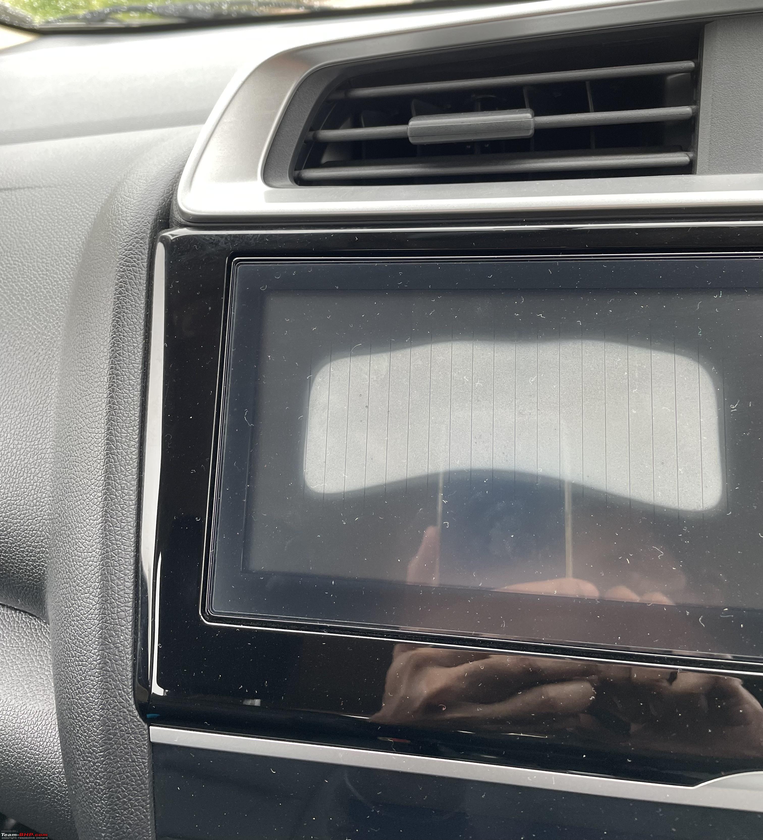

Has anyone noticed this on the digipad 2.0? I see foggy screen after a few days of rain. Have a covered parking on 6th floor, so the car isn’t subjected to natural elements unless am out driving.

Nope, despite my car being used for almost a year in one of the rainiest place of east UP. May be because the ACC is on full time. I do see some dust inside the screen though. Does the fogging disappear after using the AVN or turning on the AC? I guess there is some gap between the touch screen and the top layer of protective screen where dust and water vapour can find entry.

Yeah 15 mins into the drive it disappears, at times faster. My ACC is always running at 24 degrees whenever the car is running.Can SVC guys fix this? Problem is by the time I reach service centre this would have disappeared.
And to fix this I guess they have to get the AVN out and put it back again? Won’t that lead to more gaps as it would be a manual process unlike factory fit

Make a video of the foggy screen with details like your vehicle registration number from sticker on wind screen/ VIN from lower end of B pillar and odometer reading. Share the same with CRM/ workshop manager. Ask them for a solution. Let’s see what they have to offer. There could be multiple causes, one being gap in screen. There may be water leaking into the cabin from AC( blocked ducts), common with Tata SUVs or break in door beading. Since the AC duct is just above the AVN that may also be causative factor. A wet towel or umbrella left overnight in a car can cause accumulation of moisture in cabin. If your Jazz is in warranty period you may even push for a replacement. But the cause needs to be ascertained first. The HU as I have seen in other vehicles is held by plastic clips and screws, opening and refitting to factory finish should not be a problem.

yes , happens all the time, especially during humid / monsoon weather.
the AVN unit in my car does have some amount of dust, and guess there's a gap somewhere.
But this problem goes away after driving for sometime, and doesn't affect the performance of the car or the avn unit, so I have not raised any issues with the service center.
