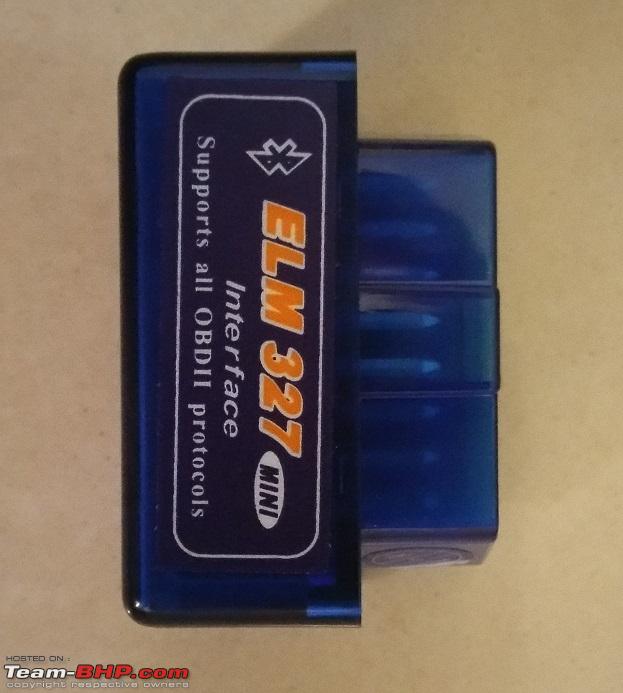

Got my OBD 2 adapter today; I had ordered on ebay on Thursday.
Thank you A4anurag and Sathyasuri for your inputs on this thread.
Connected the adapter to the tank and it was easy to pair it from the Bluetooth settings on the phone. Downloaded 2 Apps from Android Play Store to try - Torque (free version) and OBD Doctor. Both applications recognized and hooked on to the adapter in a few seconds.
The adapter I bought -
Mahindra TUV300 : Official Review-20160305_151543.jpg
In case anyone needs help, the OBD 2 port is on the left bottom corner behind the panel under the steering (as marked in this pic).

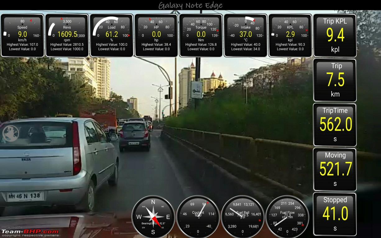

On a different note, I spent a lot of time with my new OBD 2 adapter last weekend. Tried several free apps like Fun2Drive, Scan Master Lite, OBD Car Doctor, DashCommand and finally decided to go for Torque Pro (INR 250 on Android Play Store).
Torque Pro is way better than Torque (Free) and has several options to try. Downloaded the Track Recorder plugin which allows you to record video of your drive (like a dashcam) with an overlay of stats you choose. Spent some time designing my overlay and then did a few test drives.
I found surprising results; experts on this forum can add their views.
Some points and screenshots from the video below. I’ll try and upload the full video later (you have to install a plugin on your PC to export videos from Torque Pro).
  1. The Engine RPM data was very consistent with the tachometer and the trip max and min are in decent range.
  2. The max speed I touched was 107 Kmph, and this was consistent with the speedometer. The RPM data was in comfortable range and tank had enough breath left to probably go up to may be 125-130 without struggle.
  3. The surprising part was the Horse Power and Torque. Please note, the Horse Power was calculated at wheel (and not at engine flywheel) which as per info available online is lesser by 15-20%.
When I just started the trip, the instantaneous fuel consumption went up to a staggering 81.4 kpl. This could be some inconsistent data. At this time the HP, Torque, RPM, Speed and Engine Load were all at low levels. The Fuel Flow per Minute (Bottom Right, second from Right) was also at low level.
Mahindra TUV300 : Official Review-20160308-13.10.13.jpg
When I was at my max speed of 107 kmph, the HP and Torque levels were still very low. Also, the engine load was low and the tank was cruising smoothly. Interestingly, instantaneous fuel consumption was a happy 15.3, consistent with a highway cruise.
Mahindra TUV300 : Official Review-20160308-13.09.47.jpg
When I slowed down later to ~35 kmph, the engine load shot up and but the torque and HP were at low levels. RPM was in control. Also, consistent with the instantaneous fuel consumption the fuel flow per minute was also very high.
Mahindra TUV300 : Official Review-20160308-13.09.31.jpg
At one point, when I was at ~90 kmph, with RPM of 2.4K and engine load of 26%, the HP and Torque were almost zero. Could be an issue with OBD reader or sensors? Or can this be correct?
Mahindra TUV300 : Official Review-20160308-13.09.13.jpg
At almost the end of the 8 Km test trip, the stats were as below. There were some issues with data as well - for e.g. the below screenshot says the max HP was 38.4, but it actually went up to 48 (see previous image). The Torque didn't cross 160. At most times I looked at the screen, the RPM was consistent with the tachometer, but the max figure is a little surprising at 2.8K as the gearshifts in AMT sometimes happen at around 3.5K. Will check this again in my next test drive.
Coolant temperature was consistent and in range throughout. For a Sunday afternoon pleasant drive the trip kpl was disappointingly low at 9.4 kmpl.
Mahindra TUV300 : Official Review-20160308-13.08.27.jpg
Hey Raj,
Look at this link below to get the correct ways for Horsepower and Torque.
http://torque-bhp.com/wiki/Horsepower
My tank ...
Hi rajpvrm
The data of the instantaneous FE is correct. The range of the IFE even for my polo is 5 kmpl to 85 kmpl
Next time request you to note the % of accelerator pedal input.
You will note that when the acc-ped input is low (5-10% pressed) the instantaneous FE will shoot up drastically, irrespective of the gear. This is because of the accelerator pedal vs fueling input map developed for the vehicle to achieve the Highway FE figures. Once you cross this threshold, the FE figure will drop.
Also if you drop too low, the idling fueling will increase to maintain the engine rpm and prevent stalling.
If you disengage the clutch and let it idle it will return to the normal idling ma
I have observed that if I drive any car in the 5-10% levels of the accelerator input, I get a super FE
not boasting but sharing some of my FE records on Highways with AC off on similar routes
Ciaz- 27.3, GT TSI- 21.8 Scorpio (old) 18.7 Scorpio (new) 19.8 Verito-29.6 TUV300- 19.3 Quanto-18.3 Indica (v2 refresh after 9 years) 18.4
Request you to get back on the Pedal vs Instant FE readings. Possibly we may be able to make a trend out of it and crack the engine map
