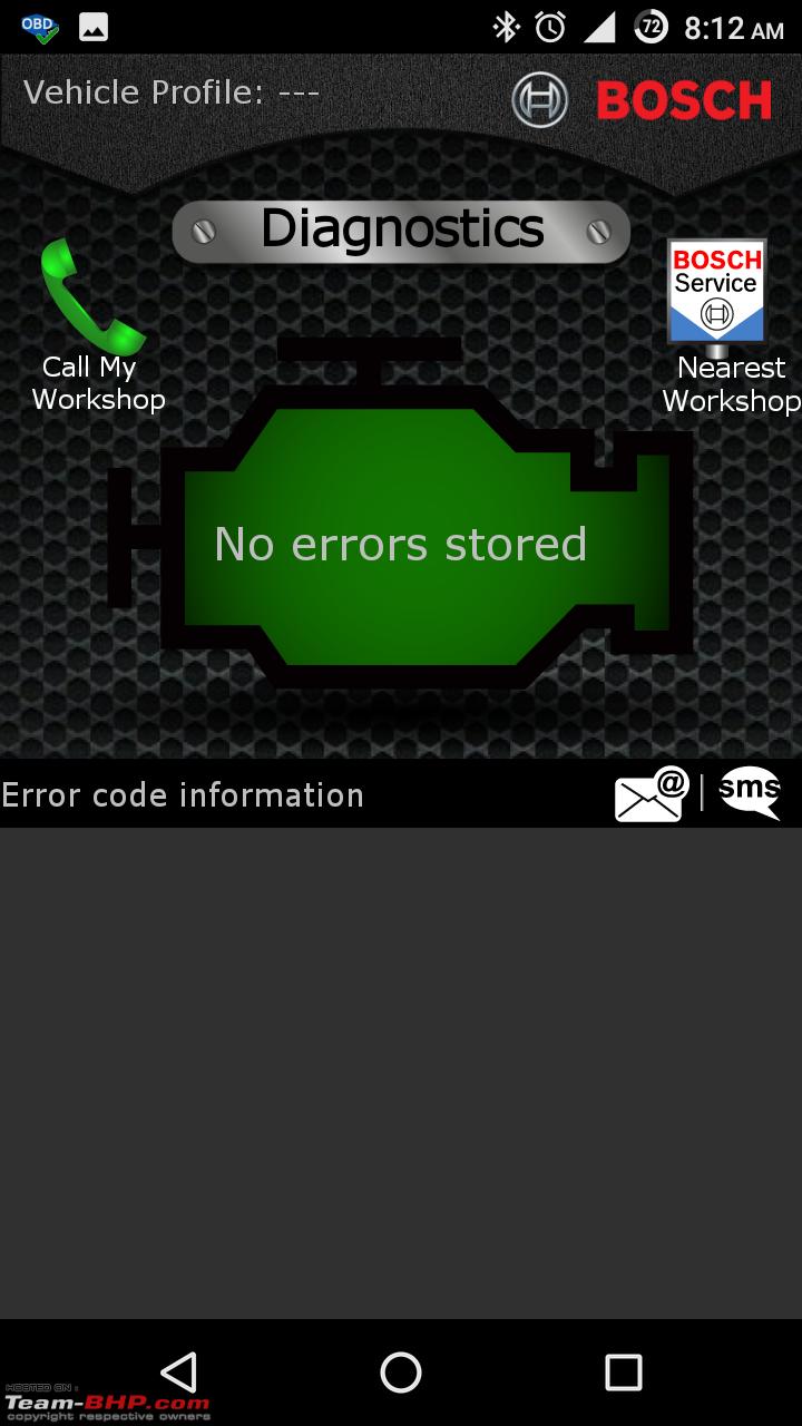

Have you tried Torque PRO App?
If you don't mind can you post the screen shot of the image where it gives out what all are the available sensors in the TUV?!
Please find the screen shots from the Fun2drive app.
The app screenshots were taken after a cold start with the engine idling.
The home screen:
Mahindra TUV300 : Official Review-screenshot_20160303081103.png
Some engine parameters:
Mahindra TUV300 : Official Review-screenshot_20160303081118.pngMahindra TUV300 : Official Review-screenshot_20160303081112.pngMahindra TUV300 : Official Review-screenshot_20160303081124.png
Errors (none so far ) :
Mahindra TUV300 : Official Review-screenshot_20160303081405.pngMahindra TUV300 : Official Review-screenshot_20160303081205.png
I found the Torque(the free version) to be bit cluttered(it is only me) and it used to crash frequently in my phone and hence stuck to Fun2drive.
