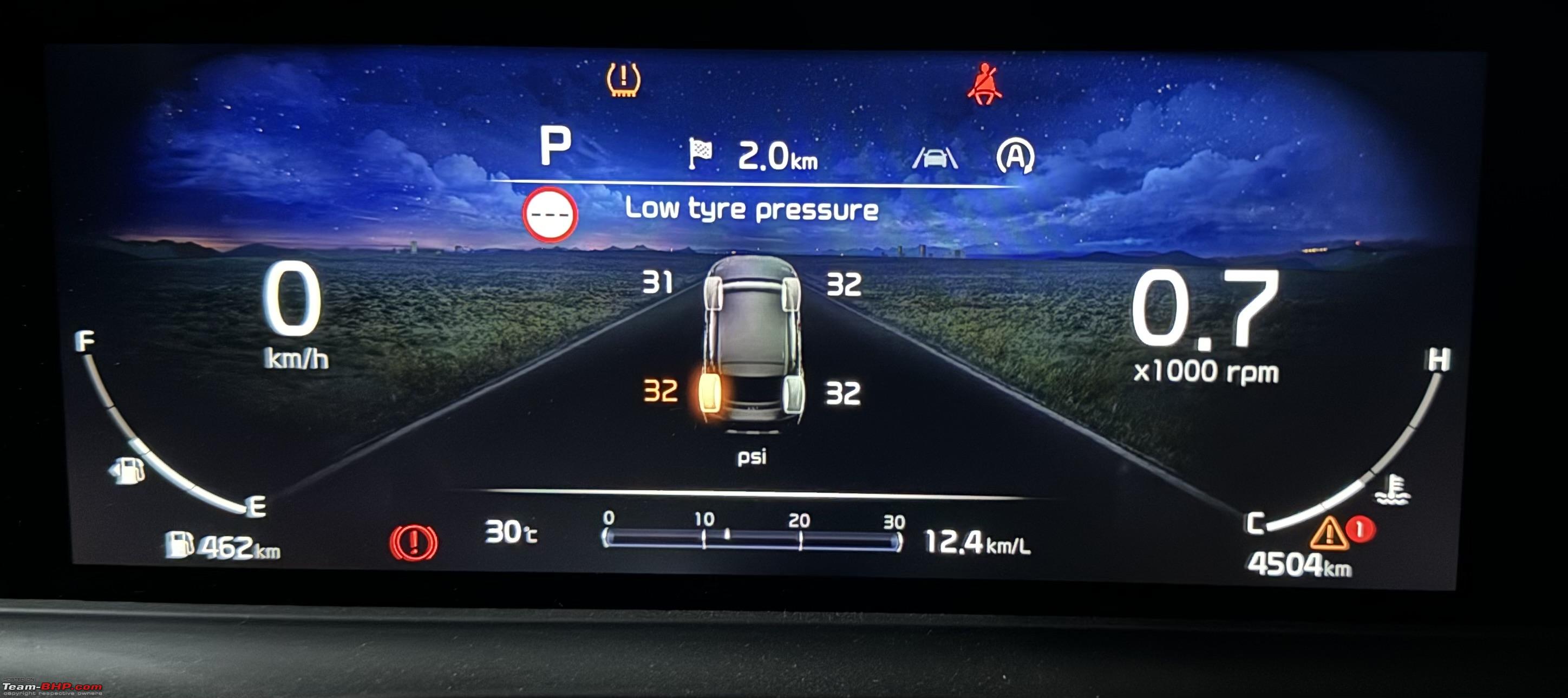

Originally Posted by Nrulz View Post
Attachment 2631839

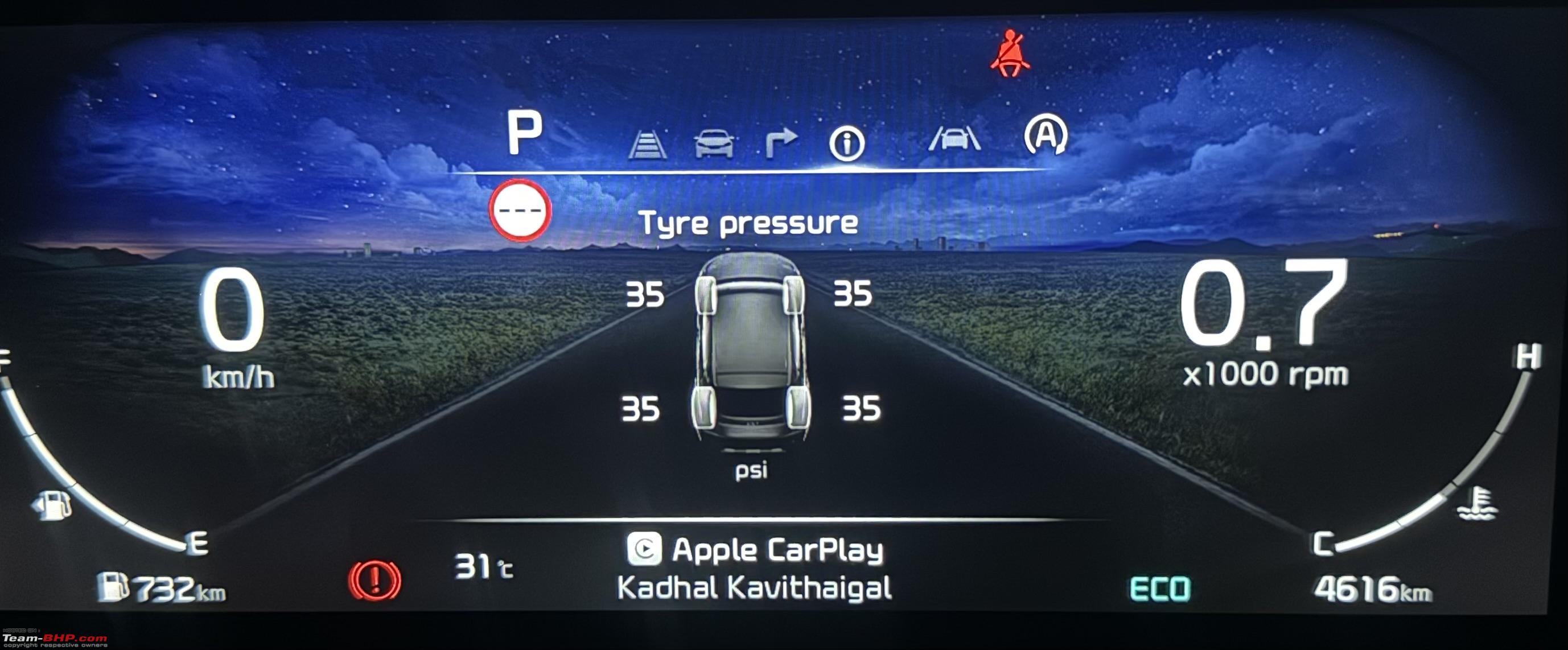

I had a similar situation (tpms error) this month, when air pressure in one of rear tyre dropped below 30 (no punctures upon inspection). I kept driving after refilling to 33psi as usual but error remained. Couldn't find any reset option for TPMS in user manual or under any menu option, but some online search suggested driving for a while after refilling to recommended tyre pressure (35), which also worked (I topped only to 34psi).
Attachment 2631842
This worked, thanks. Filled it till 35 and it's good now.
