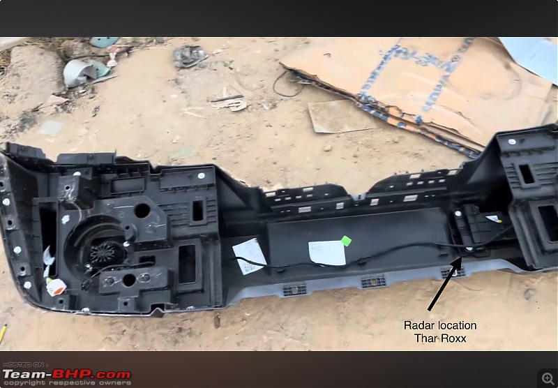

The radar is located between the right fog light and the area for putting up the number plate, inside the front bumper, attaching the screenshot from a youtube video. It lies behind the protruding silver part.

Thanks for sharing this.
It looks like the radar has to be removed from original bumper and then fitted into new bumper from the images. If this is true, then I would definitely not change stock bumper to a custom one and have issues with front radar.
Keeping radar behind the bumper would help any damage to the radar from highway stone chips flying from other cars and trucks and to some extent from front collisions where bumper gets damaged. My car has some chip marks on front bumper and bonnet due to the flying stone chips encountered on highway runs.
I do not have a car equipped with radar, so in the new car I am looking at what extra maintenance and precautions to take when buying a car equipped with ADAS and a radar in the front.

To add to this, anytime these modules are removed or refitted, they need to be calibrated back. This is an added hassle with the new age ADAS thingies. Without the calibration done units may not work.

Thank you so much, this will be of great help.
After some relief from the seller, this seems like another headache as even after changes in installation it might not work according to you. I hope at least after returning to complete stock setup except fog lamps, it works like before. Anything I should keep in mind with regard to extra wiring put in for fog lamps?

You will have to revert and check, hopefully it will start working again. If not just take to dealer and ask for a recalibration to be done.
