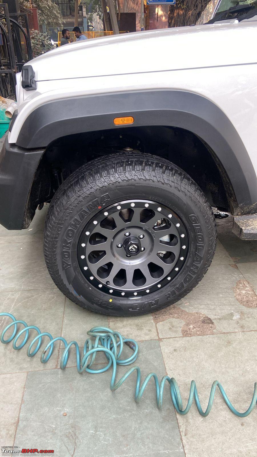

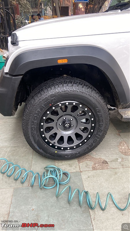

Work in progress, looks nice in the picture. When I get the car, will update
Turbanator is online now   (11) Thanks

^ Tyres - Approved, well done. The beadlock like pattern on the outer edge of alloy, I`d suggest you paint it black, let the center of the wheel remain in the gun metal grey finish. That way the cartwheel like pattern of the wheel spokes are more visible.
Kosfactor is offline   (1) Thanks

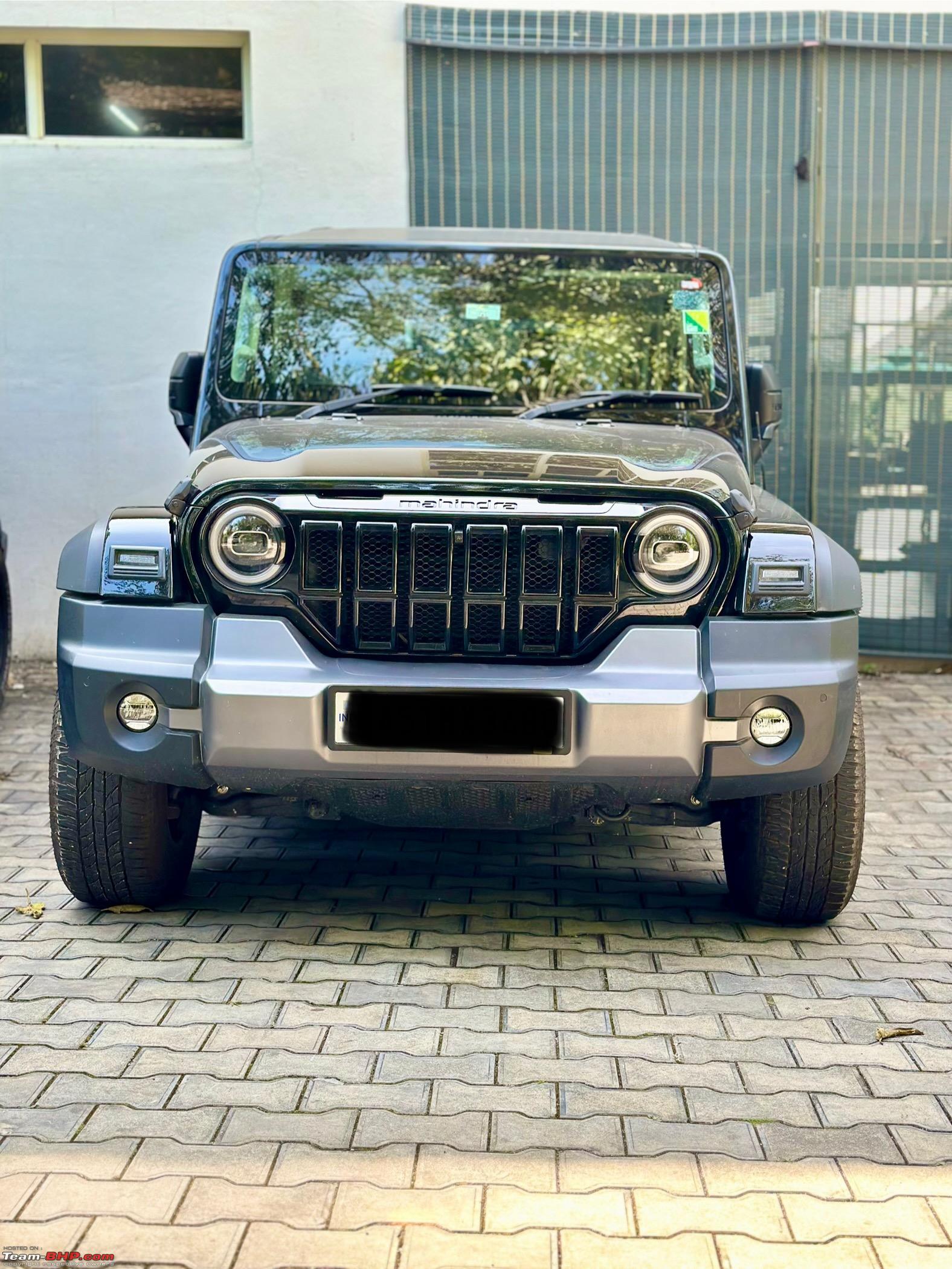

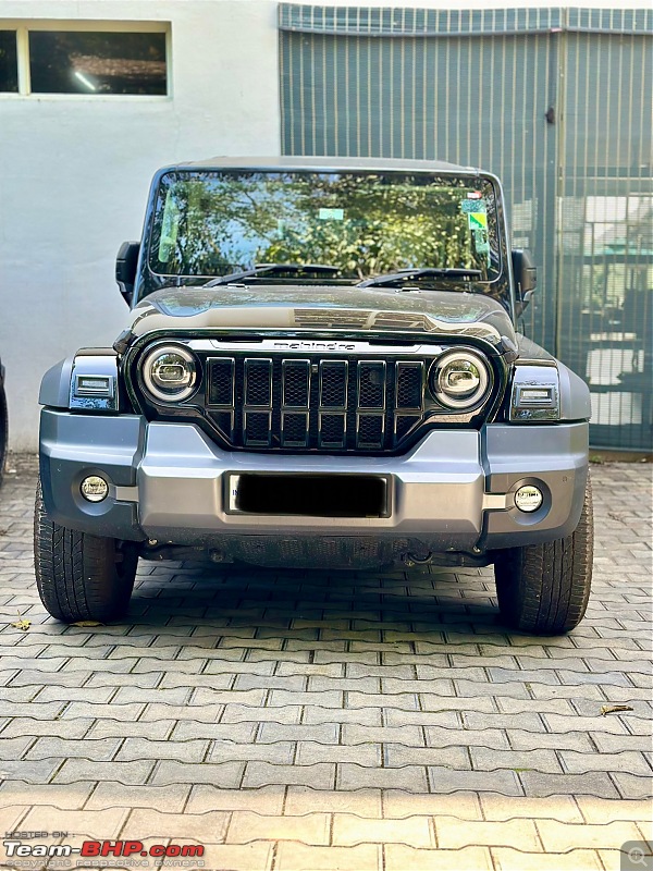

I have gone for the same wheels in matte black and the same tyres as well.
Had a road trip of around 300km yesterday; mostly highway. From a drivers perspective the overall experience was superior compared to my 2018 Honda city. The family found it more comfortable as well. It doesn’t feel glued to the roads in highway speeds in comparison to the city which in itself is not a benchmark. Everything on the road be it patches, expansion joints, undulations can be felt in the cabin but not in a jarring way. Hitting a cruising speed of over 100kmphl regularly, I got an overall mileage of around 8.2kmpl which is worrying.
Jayhawker is offline   (6) Thanks

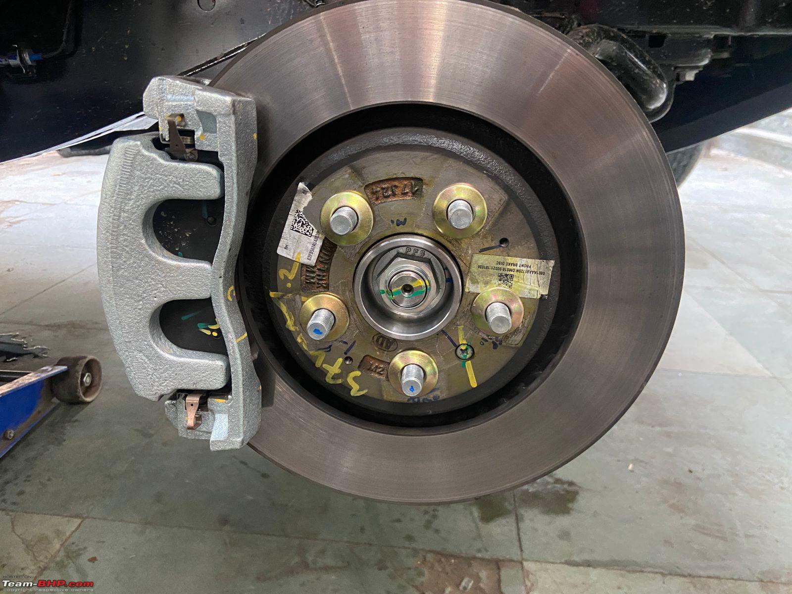

The problem seems to be rubbing with the calliper. The alloy vendor, who is in Chandigarh is sending spacers today. As a temporary fix, we have added washers and will get the car back today.

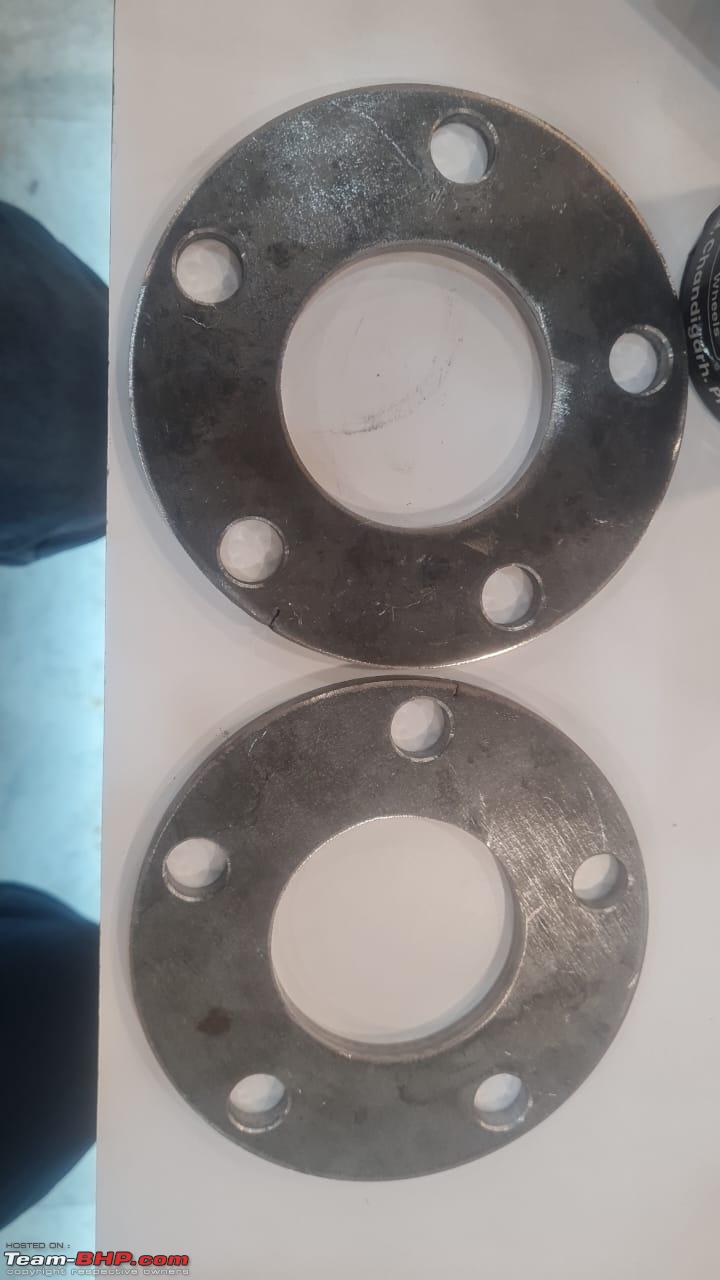

Edit - The washer is not working so getting back after fitting OEM wheels Let's see what happens with the spacer, this is what the dealer is sending. Wish he had told me about this before. Would have chosen another design.
