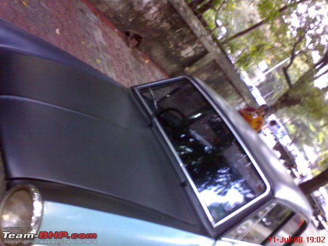

As Alot of you guys know, BLB 1144 was in bad shape body wise. So we gave it for some minor body work. The right side B Pillar was completely broken so that had to be fixed. But it was looking very bad aafter it was fixed as there was red oxide on the roof. So I decided to do this!!....

Cyrus, what are the mods on the car that you just posted. Yes, the one with the matt black finish to the bonnet and part of the fenders. Interesting, just wanted to know if it is gonna be a sleeper.

Well, After that paint Scheme, I woudnt call it a sleeper!! But here is the list of mods.
Exhaust- 4X2X1 S1 Manifold with 37 inchX 2Inch ineer diameter Free Flow Muffler with 2inch downpipe in the front and 2 inch tailpipe.
thats it And this car goes like STINK!!!
