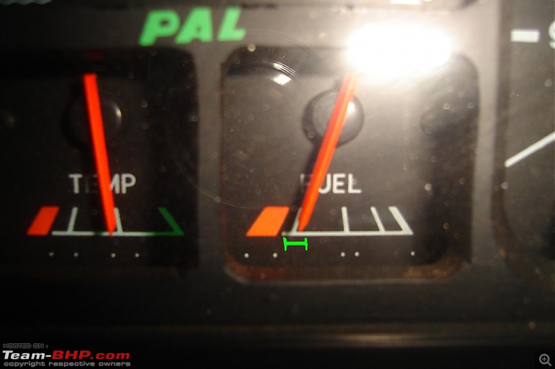

I have a few issues/questions about the fuel meter and the neck of the fuel tank.
1) When I full tanked my S1 prior to a trip yesterday, towards the end of filling, I noticed that there were some fuel spillage from bottom. It was right benath where tank is placed. It did nit leak from the lid. Around 50-100ml was visible. Is this common?
2) When I opemed the dickey, around the neck as pointed in the pic, I see a thick carpet type cloth wrapped on the neck. It was wet and smelled petrol when i felt it with my hand. Why is this so? Again, is it normal?
3) How does the fuel indicator show amount of fuel in the fiat? If you look closely it has 5 blocks including the red one. Couple are small and one is very big block. Why so? The area marked in green, the needle moves very slow and I get great mileage during this period. Why is that so?
The FIAT 1100/Premier Padmini Technical Information thread-dsc00062.jpg
