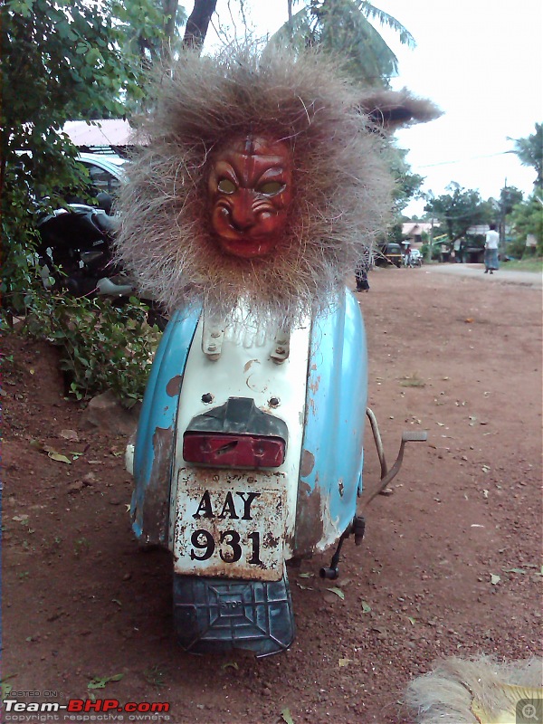

Spotted this lamby getting restored @ thrissur

Wow, a Hyderabadi Lambretta! Interesting rear mask btw!
And foby chetta,
this is NOT a Lamby, but Lambretta!
Can make out from the side-panels.
