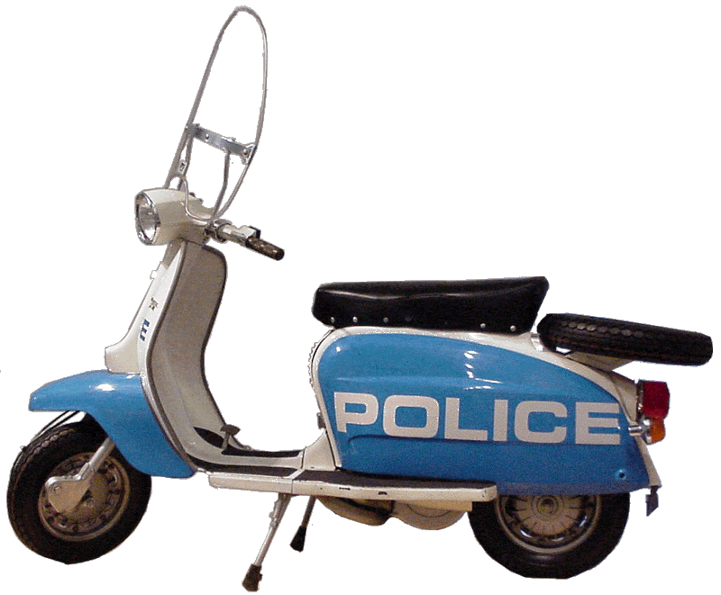

Unless you have your scooter painted like this!
