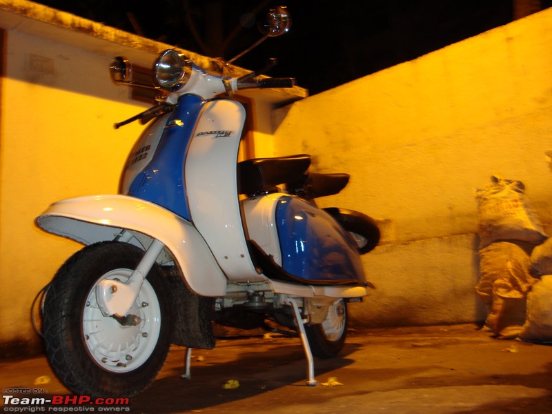

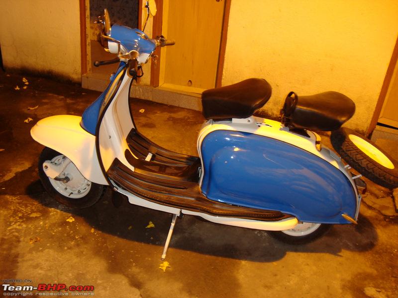

And here we are, closing the last chapter of the "Restoration of MEB 1222" book...I have finally taken delivery of my restored 1970 API Lambretta today. Few minor things to be sorted out, but for now, I need to run in the engine, using 50 ml. 2T oil per. litre of petrol (Ilango had a similar query). Should not exceed 40 kmph for the next 800-1000 km.
The horns fitted under the scoot actually made people move out my way faster, when I was riding back home. Maybe it sounded like a yellow board cab was approaching
Here she is folks....MEB 1222!

Stunning, buddy ! Please accept my compliments.. Once again, lovely colour combo.
BTW she needs a more exotic setting for photographs. Please take her out and snap her !!

Amazing looks Sid, Congratulations. Keep motoring it often.
Thanks! I had used this setting to photograph the scoot when I first got it, so decided to use it again, to get some kind of before / after resto pics. Will use some more exotic locations.
Thanks buddy! Your Vijai is looking classy too...full on as its a DIY project mostly!
