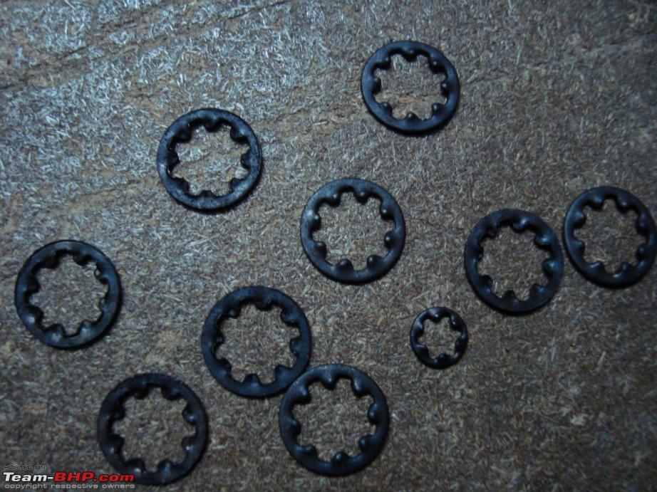

Some pics of some of the replacement parts going on to this scooter:
